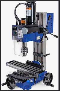

Thanks, Daniel. Let me explain what exactly I mean when I said ProxxonMF70 is not recommended for drilling. In principle, drilling means controlling the speed and feed. While controlling the speed is OK (it is electronic), maintaining the feed when the Z axis resulted in too much backlash and is hard to move is impractical. Also, it is difficult to feel the drilling process because the feed is mechanical, if you understand what I mean.
This is also a combination of a mill and drill press, and here you can control the feed you would normally do in a drill press.
