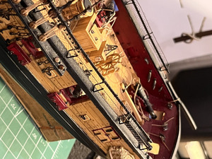

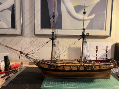

I've been working on the Syren since Christmas 2020 when my daughter gave me the kit as a present. Worked on it steadily until I thought I could make 2 model simultaneously. I found this hard to balance both so I decided to concentrate on Syren until finished. I think I should post a couple of pictures at the present state of completion.tempImage5Hj965.png
So this is where the log starts. I have to finish the ratlines on main mast and the rig the topmast shrouds, backstays and forestays. Sorry the pictures got rotated no sure how but I'll work on posting.

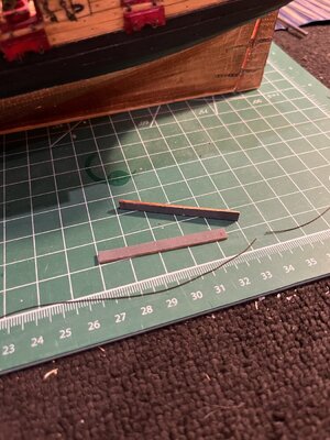

Below are the spacing boards cut to the spacing required minus the width of the ratline rope knot. In this case the spacing is .25 minus .01 times 2 or .02 so the board is .22 wide. 320 grit sandpaper was glued to the boards to keep them from slipping. I've found that using glue sticks work much better than rubber cement and there're easier to remove water dissolves the glue.

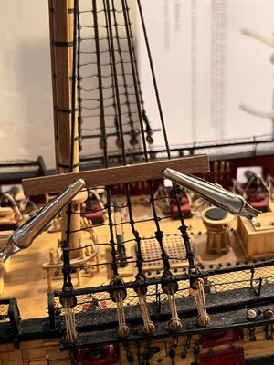

I plane boards on each side of the shrouds and clip them together. I use alligator clips but anything will work. I find that another benefit of this method is keeping the shrouds from being pulled together also allows the knots to be pulled tight with misshaping the shrouds.
