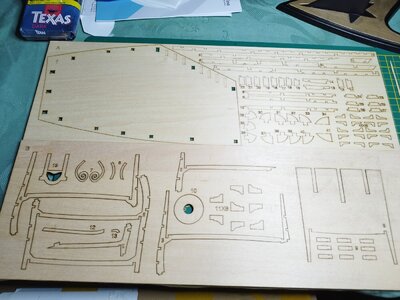

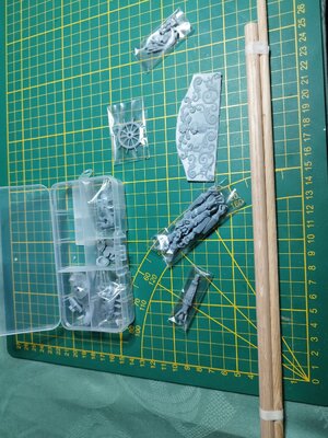

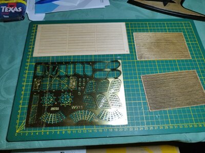

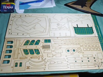

In the box are the next items :
IMG_20231208_082426.jpgIMG_20231208_082451.jpgIMG_20231208_082639.jpgIMG_20231208_082814.jpgIMG_20231208_082913.jpg
And off course a few resin ornaments.
It is a lot bigger than i expected actually. But still i guess it will be fun to make.

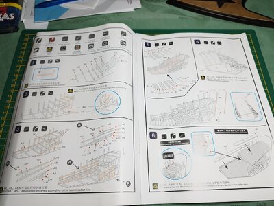

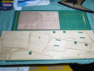

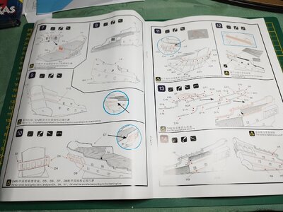

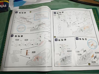

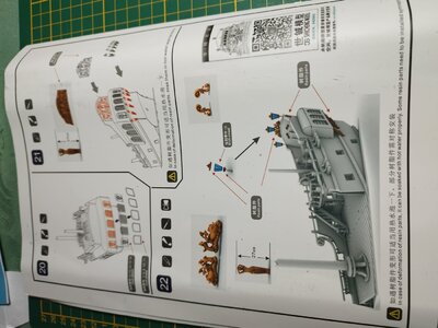

The description isn't much but the drawings are good.
IMG_20231208_083159.jpgIMG_20231208_083208.jpgIMG_20231208_083225.jpgIMG_20231208_083229.jpgIMG_20231208_083236.jpg
If i look to the description i can't help it but i think it looks like the descriptions you get when you make a plastic model.

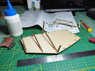

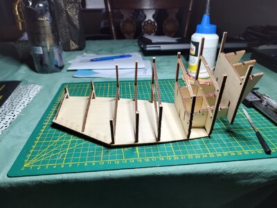

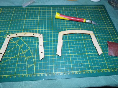

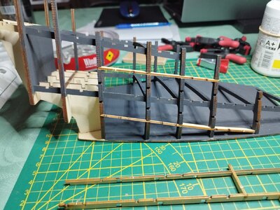

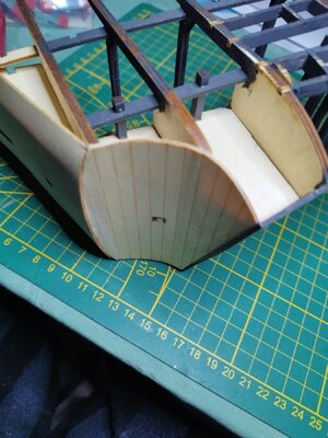

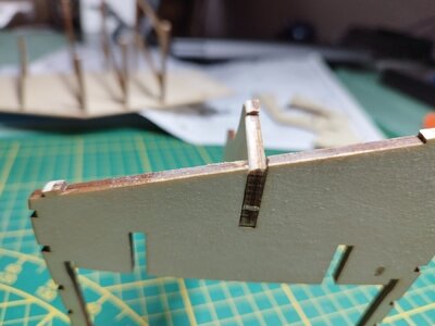

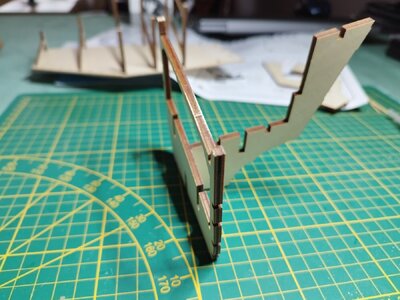

So first i started by cutting out the frames and placing them on the 25x14.5 cm base plate.
The stern frames need to be sanded at an angle before they can be placed.
Small error in the description, frame 9 and frame 11 should be placed the other way around.
But this isn't a big problem.

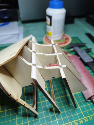

At the back of the cabin it needs to be sanded so that it runs nicely.
After this I thought it would be smart to paint it in advance because you can look into it and I don't know if I can get to it later, so I have already painted a big part german gray.

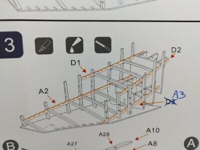

Next the description said i need to take the next parts on the model, a2..d1...d2....d3.
But d3 doesn't fit at all and before i made it fittable i first look again to the wooden parts.
Everything fits great so why doesn't fit d3.
When i looked at the wooden plates the provided with the model i saw on plate a a better piece.
D3 had to be A3.
After the glue is dry i will paint this also German grey.

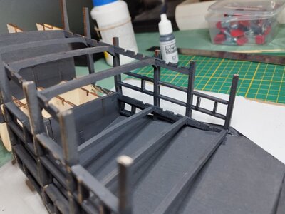

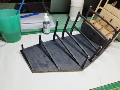

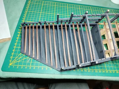

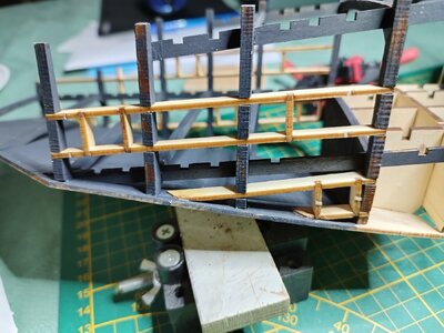

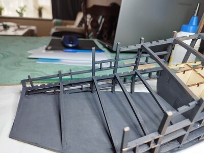

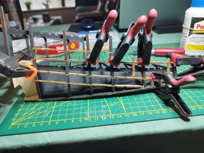

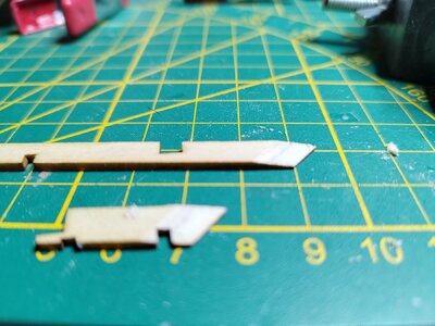

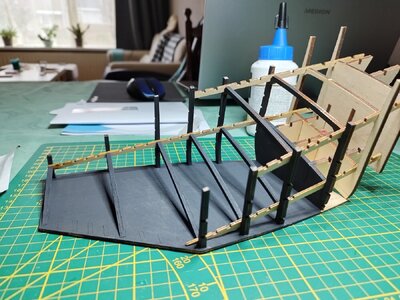

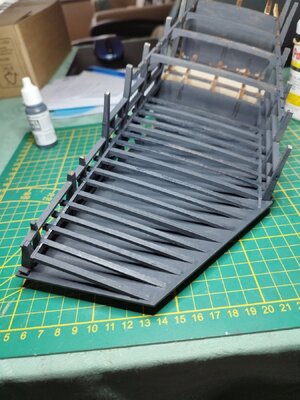

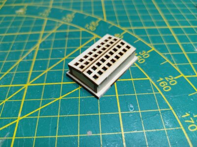

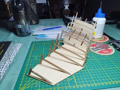

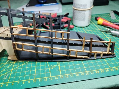

Next i started with making the framework for the gunports.
This is made out of a lot small fragile pieces.
IMG_20231214_095106.jpgIMG_20231214_095111.jpgIMG_20231214_100234.jpgIMG_20231214_103916.jpg
Some parts need to be sanded
Especially the ones who make contact with the basement plate.
I first dry fit everything before i glue it all together.

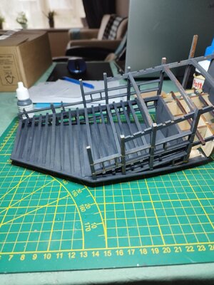

And then i painted only the parts who are visible from the inside. Because i still don't know what you see or not see when the decks are placed.

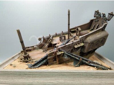

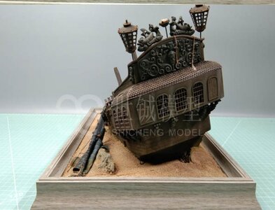

Also i found a example on the seller's site of someone who built this diorama. It looks amazing and im thinking to try to make something like it.
First I thought it is an error in the kit, that the gunports are not vertical - but 2 seconds afterwards i remembered, that it is a sunken ship / wreck which is not "normal" ..... crossing the fingers for your intervention and hpe to see soon a further progress on this project Thumbsup

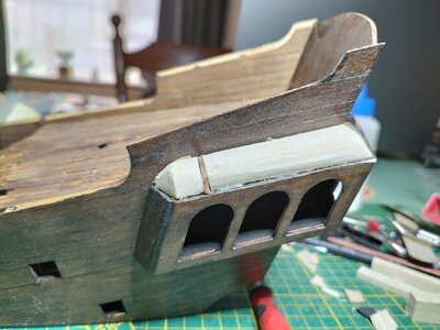

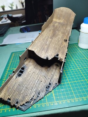

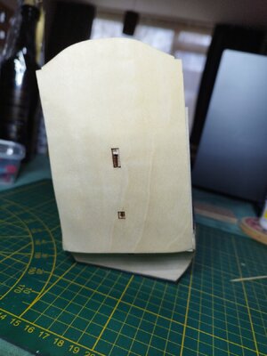

First I provided the back with the ready-made parts.
The curve is easiest to make by first wetting the prefab part, the same with the 2 rear panels of the cabin.

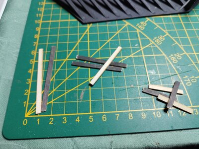

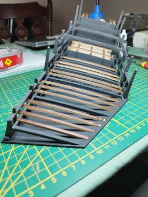

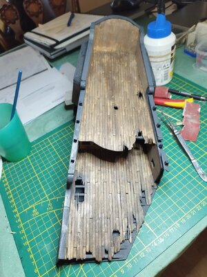

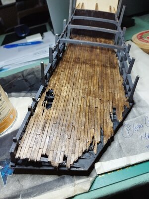

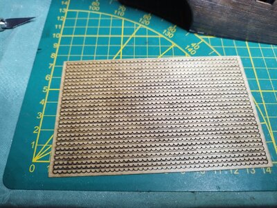

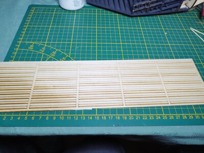

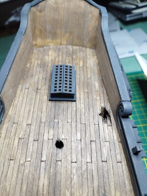

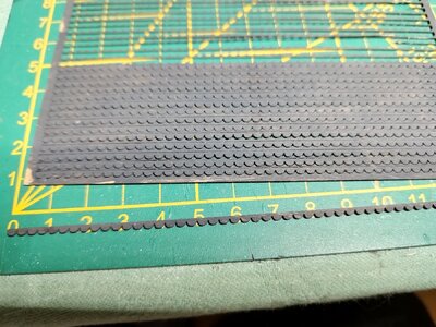

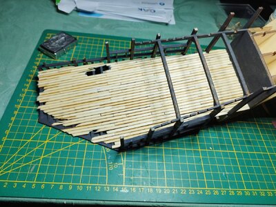

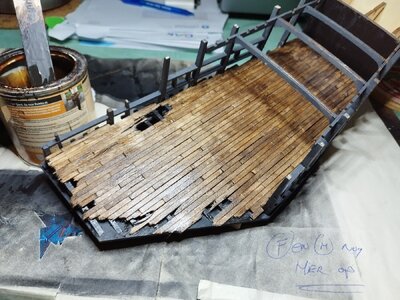

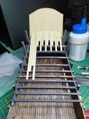

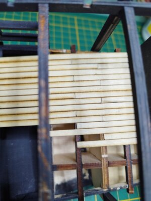

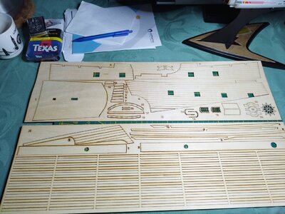

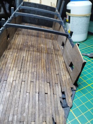

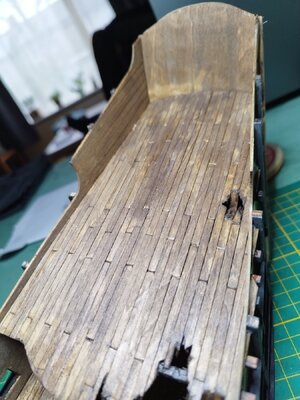

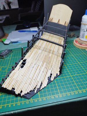

The planks to close the deck are small slats 70x3.5mm on a plate.

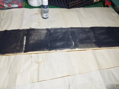

I first painted this german gray on the bottom.
After this I made 3 different sizes and started
placing them in different large orders.
Unfortunately, it turns out that not all slats are the same width, but it immediately gives a certain atmosphere and antiquity to the deck.

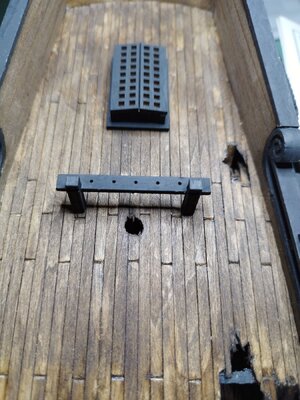

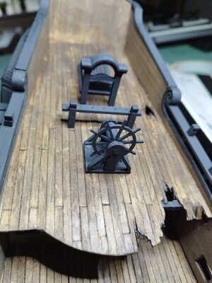

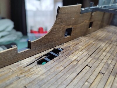

I also immediately make some holes in the deck. IMG_20231219_092852.jpgIMG_20231219_092846.jpg

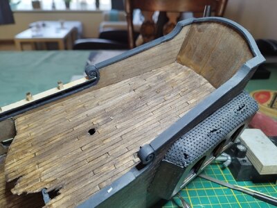

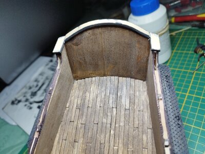

Once all the slats are in place, I sand it lightly and paint them palissander (rosewood)with some black paint mixed in.

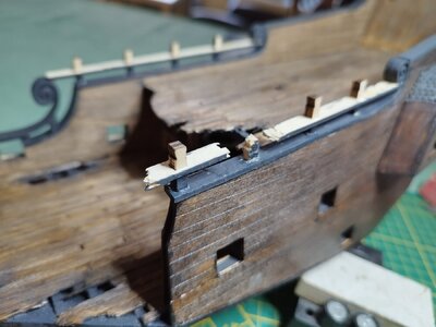

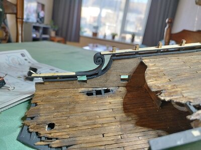

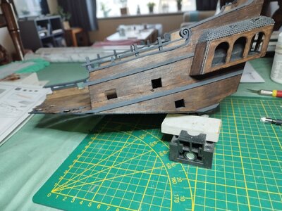

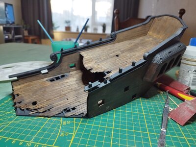

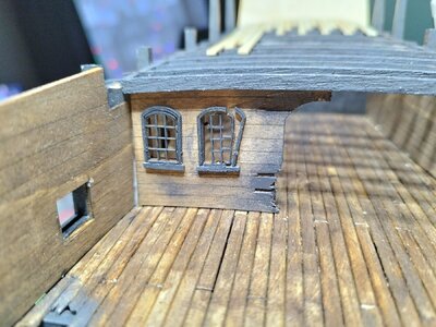

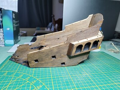

I installed the windows and frame in the front half of the cabin. Deliberately broke 1 window and damaged the side somewhat. Then painted and placed behind the last beam of the upper deck.

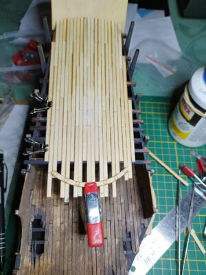

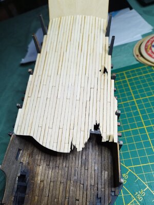

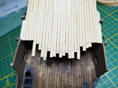

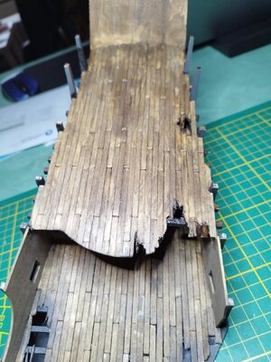

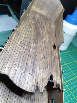

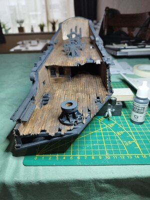

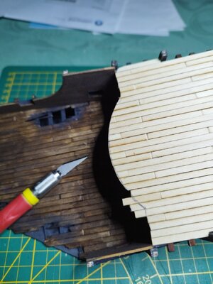

Then i continued with the top deck. There needs to be a curve at the front, which is quite difficult with loose small slats. To get the right curve I used the bottom of the fence as a template. I place the slats underneath it and mark them with a pencil, once I have finished the deck I can cut the slats on the pencil line.
After laying the deck, I drew the curve on it as mentioned.
After this, it was cut off and then lightly sanded.

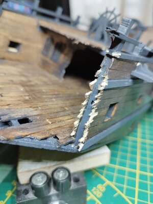

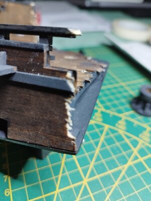

Because it is a wreck, some damage has also been done here. At the front as well as on the deck.
Painted the deck in the same color as the first deck and applied the sides and painted them as well.

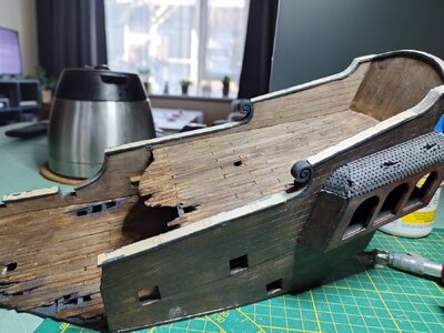

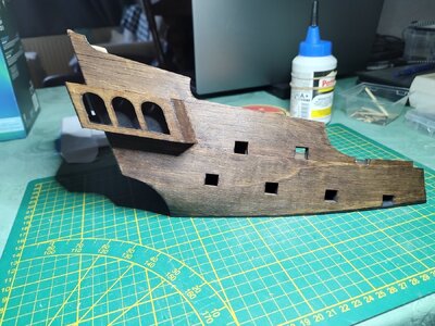

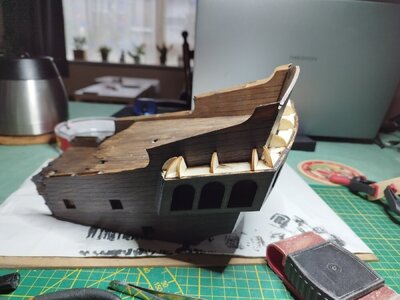

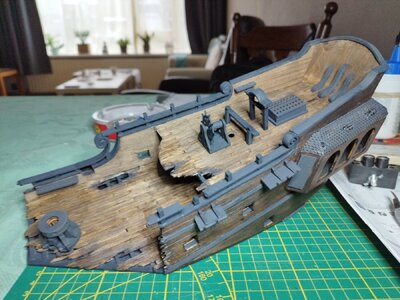

This is what he looks like now. I am very satisfied with the current result.
Now it is time for me to start preparing the preparation for the Christmas meals and will continue after Christmas. I wish everyone a very happy and wonderful Christmas.

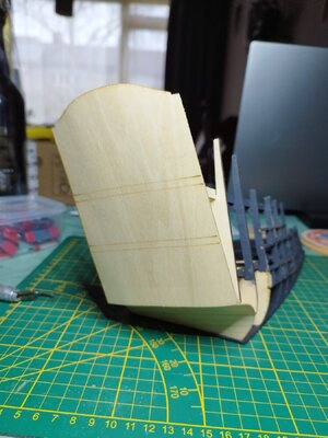

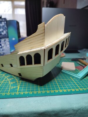

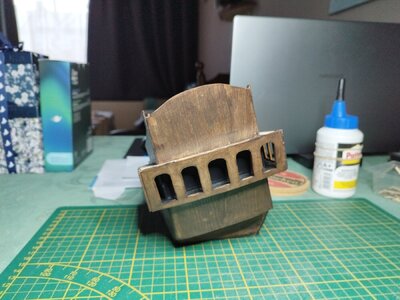

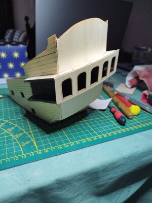

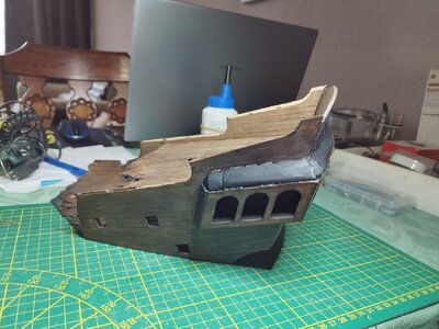

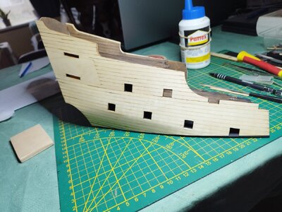

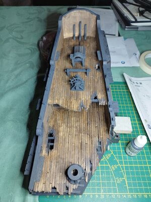

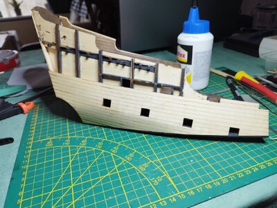

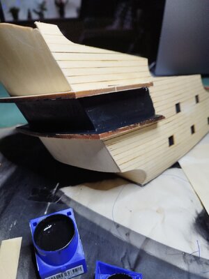

First I closed the sides.
It needs some sanding here and there.
Then the cabin will be built, first I place the top and bottom.

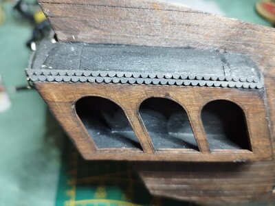

I paint this black on the inside.

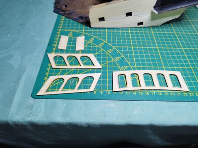

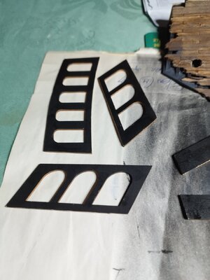

Also the back and sides where the cabin windows are cut out and painted black on the inside.
Then place the rear window first and then the side windows on the model.

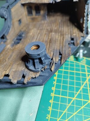

Drilled the holes for the masts and painted the entire outside a shade darker than the decks.

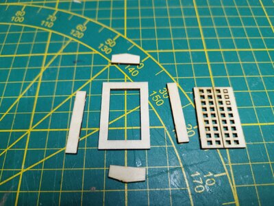

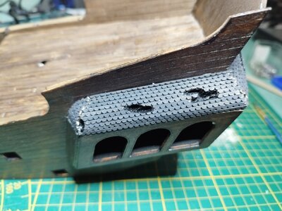

The roof bulkheads were installed on the captain's cabin.
And the planking for the roof was painted light German gray.
Placing this planking is very difficult.
So I decided to do it differently.

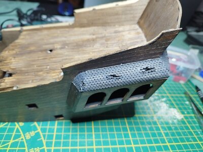

First made the entire roof with balsa wood.
Then i paint this black.
Next I glued the planking onto this.

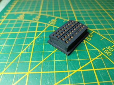

This took some time. But i immediately left pieces open for holes in some places.
After the planking was done, I made the holes a little deeper for a more 3D idea and painted them black on the inside.
Small pieces of planking were stuck into these holes to make it look even more collapsed.

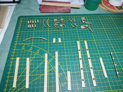

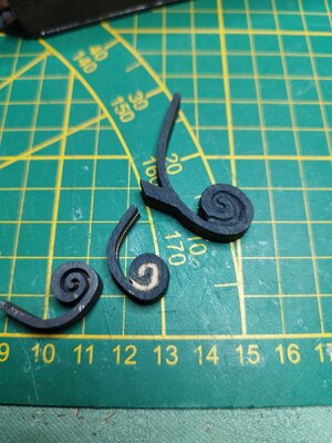

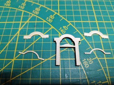

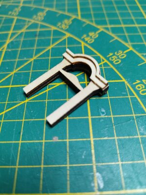

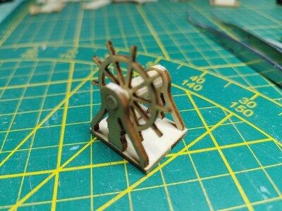

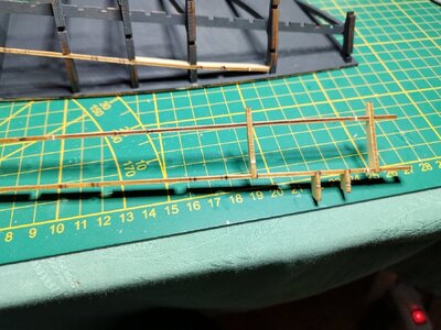

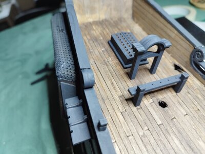

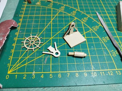

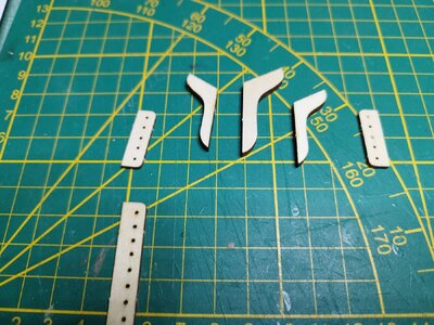

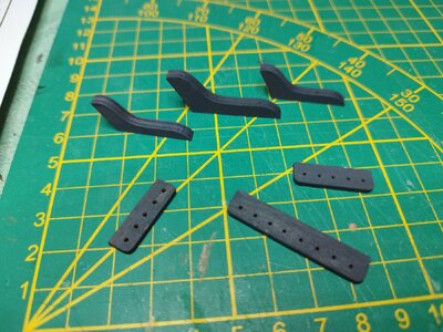

The railing consists of quite a few pieces.

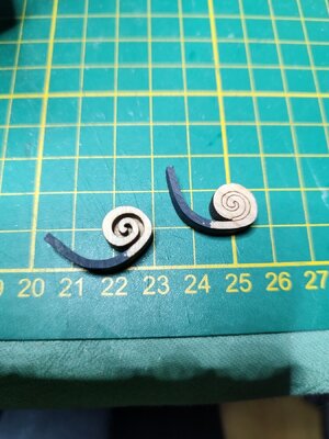

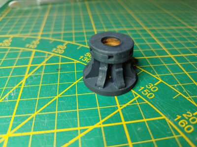

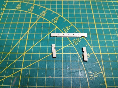

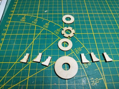

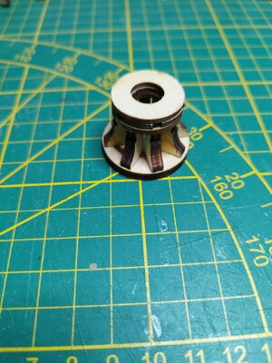

After these were cut out and sanded, I first glued the round ornaments, which consist of 2 pieces, together.
Unfortunately, only the rotation is drawn on 1 piece, this is the case with all 3 ornaments.

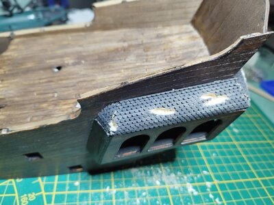

I have carefully tried to mill this in a bit so that there is more depth.
And painted them afterwards.

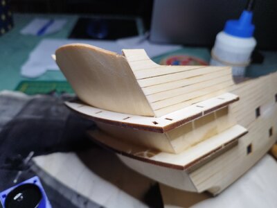

The back needs to be bent a bit and from there both sides can be placed on it.
Once these are in place, i painted it and placed the next layer on.
I also immediately caused some damage here expressly.
And then i painted this layers also.

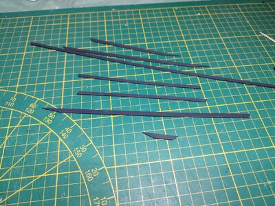

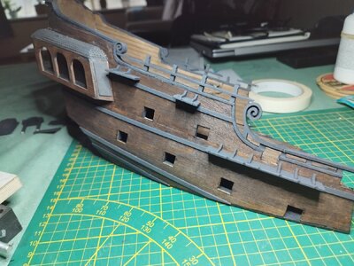

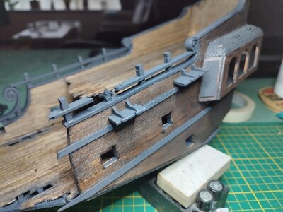

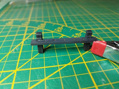

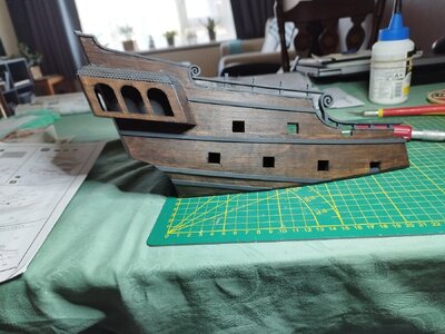

Next part are the whalers.
First i cut them out and paint them German grey.
When they are dry i placed them on to the model on both sides.

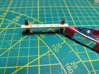

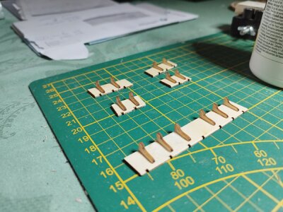

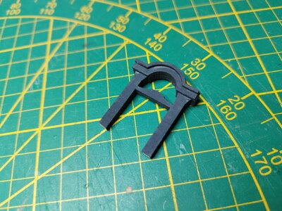

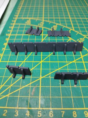

The last part to build for the outside so far is the holders for the climbing net's.
Now everything can dry before i paint them also german grey and gleu them into their right place
