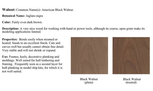

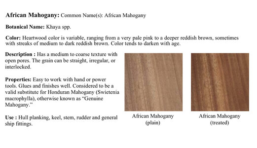

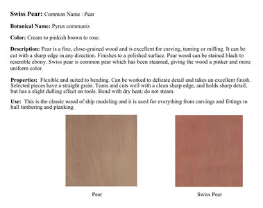

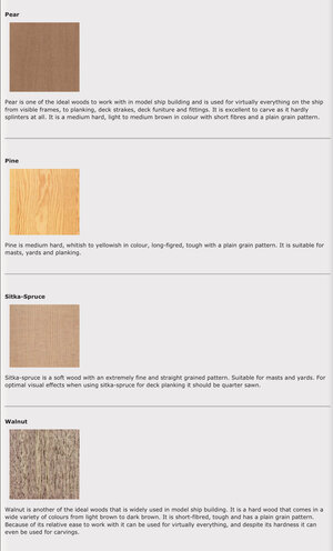

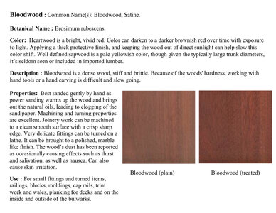

Teak is a medium dark brown wood, so you can use any light wood and stain to get the look you wish. Here is a link for different types of modeling wood. https://thenrg.org/resources/Documents/articles/DatabaseOfWoodsForTheShipModeler.pdf
attached are some dark woods that you might also consider. It will all depend on what available to you.
kevin
And give Sapele a look too
