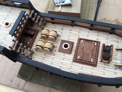

After many hours You-Tubing and a few practice runs I finished the deck and dummied the trees nails like others have by using carbon pencil and patience. The toothpick tree nails looked interesting but not for this model or time.

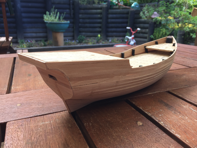

First planking was done via many new English words and chewing PVA glue off fingers. To achieve bends I first drew the on plywood how much bend was needed then hammered nails to the drawing outline. (sorry no photos were taken) Planking sat over night in the Grandkids plastic play pool then bend and attached to the plywood drawing and dried using my daughters hair dryer. Over all I think the end result wasn't too bad considering.
Gaps and slight hollows filled with water based "Selleys, Spakfiller" described as a heavy duty filler for holes in walls, cracks etc. Overnight dry and then sanded off to what may or may not have been a good finish.

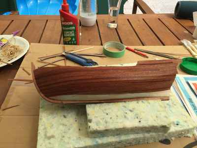

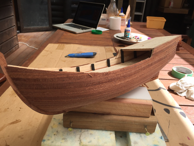

So the tricky bit started for the second planking which the instructions specified should be Contact Glue. Sadly being subject to COPD I searched online for an alternative glue and eventually found a water-based product "Ados Greenstik" contact adhesive. Application was super challenging and dare I say I managed to stick almost everything together except for the second planking. perseverance and a few wines got the desired result

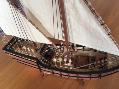

Birds eye view of the deck as I stumbled along very much confused by the supplied instructions and whilst it was easier to follow the colour photos of the instructions, sharper, clearer photographs would have bee ever so much more helpful.

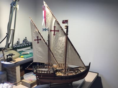

Thinking maybe it was time for the mast and rigging and stuff that makes the boat go forward. By this stage there was so much learnt, many 'wished I'd known' and Ahuh! shoulda done it differently.

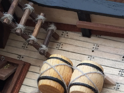

The fuzzy ropes really got to me and while happy with having finished La Nina I wasn't at all satisfied with the rigging and Artesania latina's supplied ropes. The FUZZ really got to me.

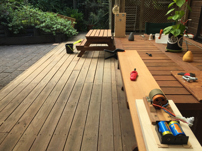

After lots of failures and a couple of mishaps I added a revised Bit 02 from a 40 year old battery motor I found in the attic.
All up it seems to work. the biggest problem has been getting to same stretch tension on all threads and making sure the wife doesn't start looking for her sewing kit(s)
