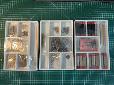

Accessories also look detailed. I decided to order the upgrade kit for the cannons, but it haven't arrived yet which is alright since they will be worked on later in the future. I was interested in spinning my own rope but I might not be so anymore after looking into how people create their own improvised ropewalks. I couldn't find ready-made ropewalks anywhere online, so we'll see about that.
