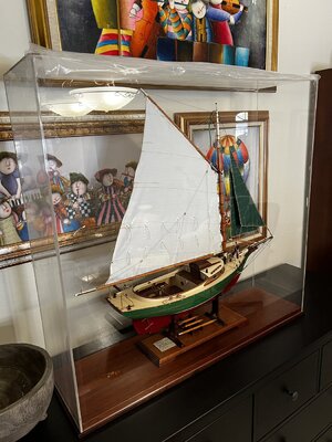

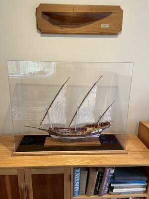

I’ve made several cases out of 0.125”thick acrylic sheet. 4’ x 4’ extruded sheet can be purchased for $100 - $150 if you're able to pick it up from a local supplier. The best solution for making the seams is to use Weld-on acrylic cement with a needle applicator. Detailed descriptions of the process are described in several Youtube videos.
An example of one of my cases is shown below:E68448C6-570E-4B1C-8F17-2FC793825230.jpeg

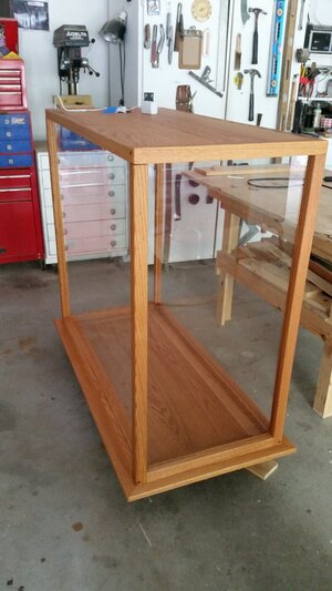

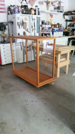

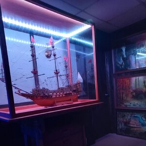

Hello everyone I have made my own cases, the one for my Sovereign of the seas was just to big and expensive to buy ,I made with plexiglass and oak wood with a removable front glass and top, I also bought a cheap light on Amazon that has like 20 different colors, the different colors turned out to be pretty cool, all the plexiglass is removable to clean once in awhile ,they sit in slots I cut in with the table saw . Thanks everyone

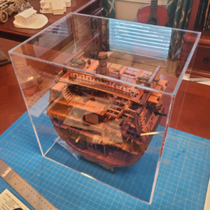

I got mine for my Bonhomme Richard cross section from shopPOPdisplays.com:
This one cost me $131 delivered. It's 5-sided, professionally glued together, only needing a base, which I am making.

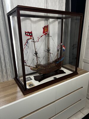

Here is my two cents.

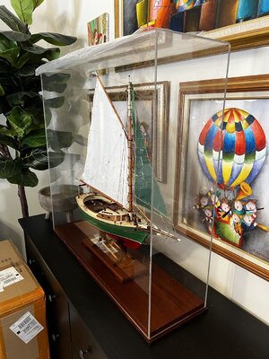

I built this case out of mahogany leftover I found in the shop I used to work.
I retired but still go there to work as a subcontractor once in a while, so I still have access to goodies.
For the bottom base I used white acrylic.
The right side acts as a access door to the interior.

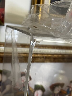

This is another case that I ordered from Faulkner Plastics (https://plasticproductsinc.com/).
It’s a three pieces case.still has the protective film on it.
This is the cleanest case you could have since they build it with only three acrylic pieces, two for the sides and one complete bent piece that cover front and back. This case cost me $230.
