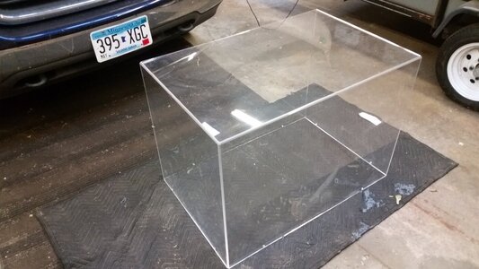

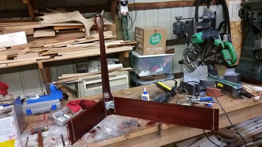

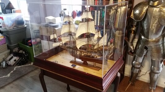

That's a tough problem. I was lucky to find a museum display cabinet on Craigslist.org locally which originally contained a dinosaur skull. I used the plexiglass box from that for my case. It wasn't scratched, and the edges don't have wood that blocks your view, which is really nice. That cost me $150 USD. It wasn't tall enough for my model, hence the riser around the bottom. An old Chinese-made desk which a friend was about to discard provided the legs and other parts to help create a nice ship model display table for the case. You'll need a router table, a table, and a sliding compound miter saw for the heavy work. Another lucky find, since Queen Anne style legs are hard to find over 20" long and quite expensive when new. Making a case inexpensively is difficult if you can't scrounge the parts from wherever you can find them. That's where searching and luck come in. Your model is small, so you will have and easier time finding a solution, statistically speaking. Ship cases manufactured for models are extremely expensive, usually around $1000 USD for a large sailing ship model, and they often do not come with glass or acrylic or Plexiglas! I was looking at using glare free acrylic for my next case, but the amount I'll need will cost $950. The wood case will have to be made by myself in the shop to keep costs low.
My first case, using salvage.
Wow. Great looking. I’ll start hunting around for parts in hopes of coming up with something. In the meantime, lots of Q tips to try and keep it looking good. Thanks.

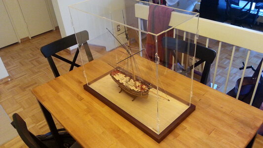

I like the cases from AcrylicJob.com but is there any way to miter and glue the edges and dispense with the distracting tabs at the corners?
You really don't notice the tabs, to be honest. You could probably saw the tabs off and glue the case together.
I really like that the case is easy to partially disassemble. I lift the top off and slide the front away to get at the model inside. Lifting the acrylic box assembled is quite heavy and is a bit nerve-wracking. Not as good as a door but close enough.
The one I got was 23"L 10'W 20"H, 3/16 inch acrylic.
