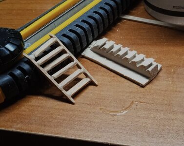

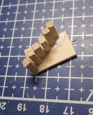

I tried several ways to make the stairs, but in no case did I succeed.
Do you have any teachings to help me achieve them?

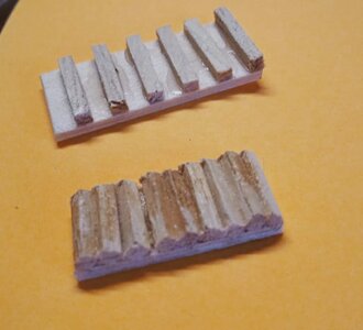

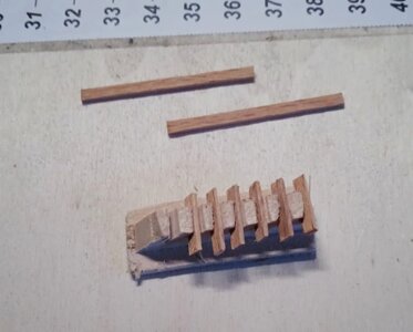

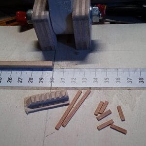

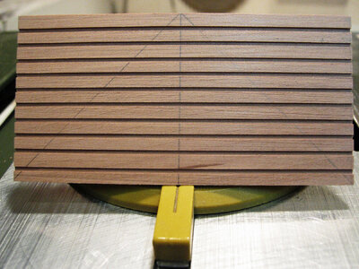

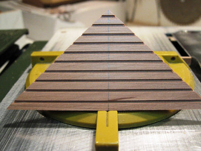

Not so horrible... the lower example is close, but you need to cut the sticks to a triangular cross section before gluing. Also, you could use somewhat bigger sticks. A typical step is 12 inches (0.3 meters) which converts to 3 mm at 1:100 scale. I doubt that 4 mm sticks would look out of scale.

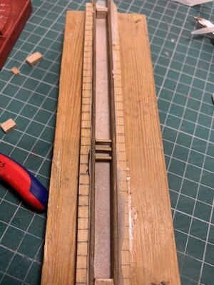

You need to make a jig which will hold every perpendicular and plumb.

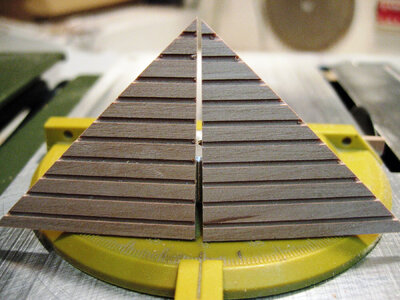

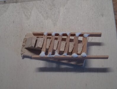

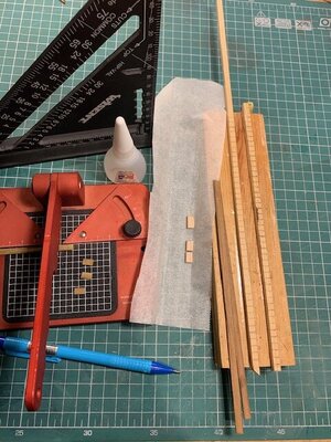

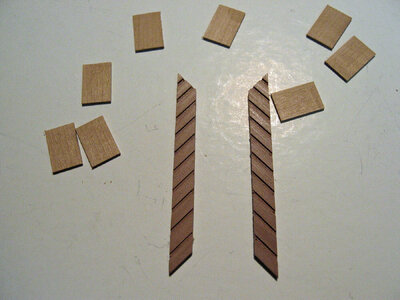

That is the way making stairs in any size.All you need is
A precise cutter to cut the stairs steps
Stripes to fix the sides of stair side panels
Pergamon paper (with permission of my dear wife ofcourse) to release or remove the finished glued object from the form without damaging.Baking paper or thin stretch film used protects while glueing the stairs with CA Glue from unintented fixing to the form.
The details are in the attacments.
Good Luck

Hi Korsar,
I'm also studying the method you described.. I'll do some tests as soon as possible.
Thank you
Bergamon paper should cover the bottom and the sides of the form that means the paper is placed in U form with 90 degree edges,corners.you can do a long ladder at once and it which length is necessary the equal angle adjustments between is important for a uniform tesult.Using Ca glue accelarates the production process
