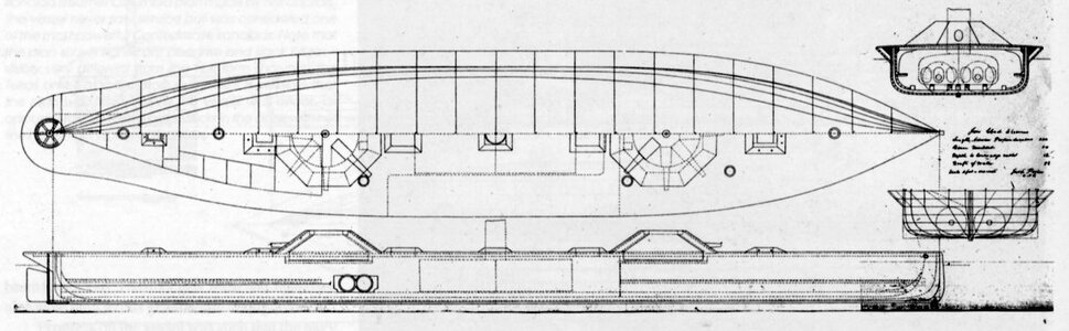

A note on the plans for the ship.
I only found one proper picture of her plans, which was on Wikipedia.
There are notably no numbers or measuremnts, but it is all that i found, so it was the basis for my plans.
I used the originals to create plans that fit my purpose.
Basically i "redrew" the lines in Gimp, mirrored them and that way got me a deck plan and a "top-down-lineview"(not sure what the proper term would be).

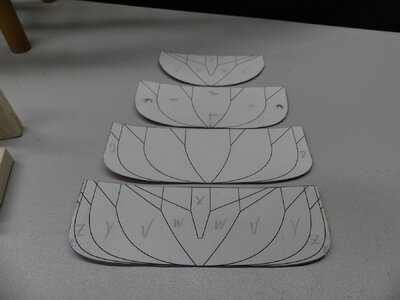

While these plans already are very helpful, i needed a proper template for the stations/frames, thats why i created these plans, closely following the original.
Front frames
Rear frames
I decided to do a "main"-frame, the curved line going up into a straight line till it meets the deck(top most horizontal line) and an addon/balcony style extension for the outboard part of the frame(the triangle). In later pictures it will become clear what that looks like.

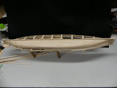

This is the first picture taken of her. At this point the frames are all done and i started the planking process.
In this specific picture you can see the pins i use to fasten the planks in place till the glue dries enough.
My goal so far was to have single planks running from one end to the other, which at first didnt work out for one reason or another, mostly because planks broke. I also had to replace three broken plankends where i wasnt carefull enough when clamping them while glueing.

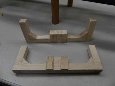

I dont have any pictures from the frame-building-process, but i do have two left over frames that sorta show the process.
The frames were done from 10mmx10mm Balsa and "interlocked" in the corners. I probably could have done a better job of showing that, but its visible in the first picture on the underside.
In the middle you see a reinforced double braced part, which would be cut/filed out to fit on the keel.Which can be seen in the following.
I decided on a "real"/"structural" keel made from plywood and a "false" keel ontop, or rather under it from Balsa.

The current state sees one side being mostly finished with planking.
Even though the planks are still rough, i am genuinely happy and proud with how they turned out so far.
The pattern i did in the planks turned out not just usefull for getting the curvature done nicely, but it also looks good.
Though i am not sure if it is historically accurate.
I also tryied a new technique to fill up the holes left up by the pins i sued in the glueing process. I used offcuts from the planks cut in a wedge and stuck them with liberal amounts of glue in the holes, waited a moment and cut them off. Afterwards i shaved them down a bit. Currently they are drying with the rest of the planks. WHen i do the next work on the planks i will sand/shave them flush with the planks.

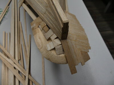

I just finished work on the lower hull. All planks are in place, the first round of sanding took place and smoothed out the planks nicely.
The "balcony" planks have been figured out and nearly finished.
I build up the empty volume with bits of leftover balsa. It didnt need to look nice, the point was to create points of contact at the right places.
The finished aft "balcony". I decided to plank it perpendicular relative to the rest of the planking. It was way easier than trying to properly cut and bend them around. It mostly workout as intended, with the exception that the angle of the planks isnt symmetrical on both sides. I did properly meassure the angle, but didnt implement it the right way. But its close.
The freyed edges are a result of me roughly sawing off the overhanging plank length.

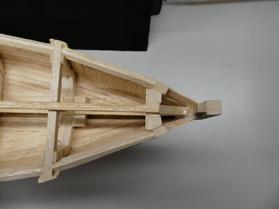

The bow of the ship, i didnt do anything with it besides adding the planks, but it maybe interesting to have a look at.
