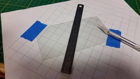

I needed windows with diamond pattern panes, so some clear plastic from some item I purchased was scribed with a razor knife to simulate the panes.

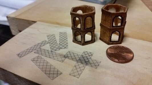

Black acrylic paint is used to stain the lines, and the excess paint is wiped away with a damp rag.

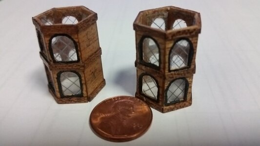

The glass panels were glued in place. Don't use CA glue like I did. It fogs the windows.

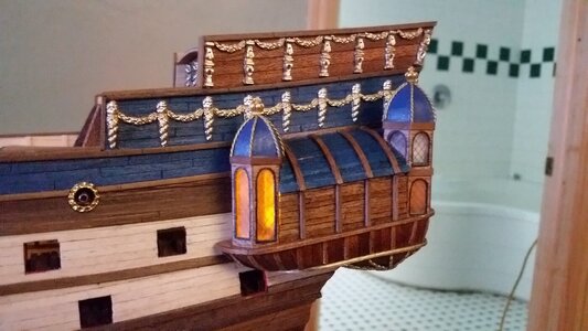

The finished effect is leaded glass windows of the correct style for this ship. They look realistic when backlit.

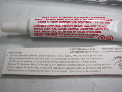

There’s a glue on the market called “Canopy glue” used, as the name implies, by model aircraft builders to glue the clear canopy to the wood framework.
Here’s a random link I found on line:
There is ''Locktite 416'' used to glue car mirrors on the windshields....And this thing sticks to everything from metal to plastic, resin, and especially wood, clothes, leather, etc......The only drawback is it will not stick over painted surfaces and it costs quite a bit. It is very liquid and will stick your fingers together in no time flat:)))) Now that's glue:))))

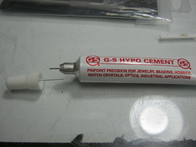

I like the applicator on this tube....It would solve many of my issues:))))))
