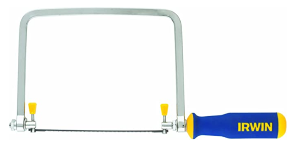

Sounds like it's back to the coping saw and sanding blocks. Slower, but they do work. Again, Dave Stevens can provide metric sized lumber. Just tell him what you need. He's great to work with.

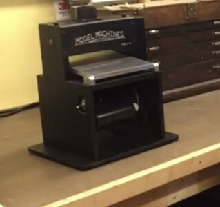

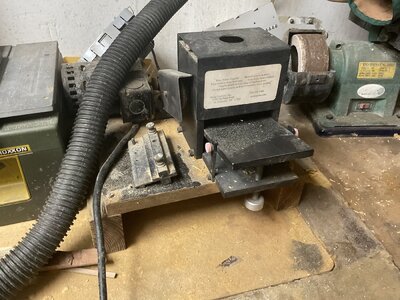

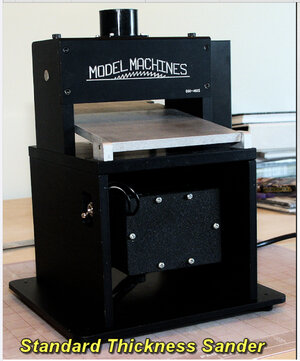

Sounds like its time to consider a thickness sander. I have an old one from Preac which has done yeoman service over the years and is starting to show its age. I did a favour for a friend recentky and they decided to give me a Jim Byrnes thickness sander for Christmas. Cant wait to get it. To get the tolerances you are referencing can only be done on a thickness sander. My Jim Byrnes works great but the saw blade has been known to bend slightly so the dimensions change. Its so easy to rough cut on the table sand and get the finial dimension on the sander.
