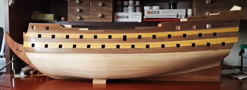

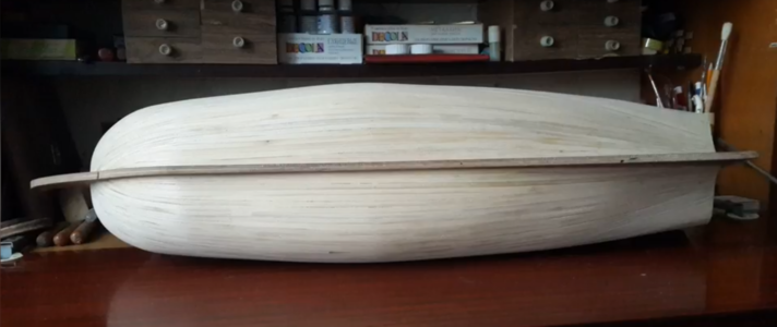

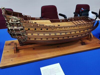

Oops.. Le Mirage! Pardon my French. Many of Corel's model choices have attracted by attention for years. I was thinking on building Corel's Le Mirage as a future build, but the hull shape has an unsightly bulge at midships, with flat areas for and aft of that. Not that this cannot be corrected, but the question is, where can information on the proper hull shape be found? I cannot find any internet information on Le Mirage. Did this ship actually exist?
The Russian builder Oleg Shaban who did this Corel Le Mirage did a masterful job and this is how the kit looks as-built, using natural wood for the color. I like Corel kits for their wood quality. The ships are a but small at 1:100 scale, but they offer 17th century ship models found nowhere else. Instructions consist of plans, with very little basic text instruction, assuming that you are already skilled at wood ship modelling. To use the rigging tables, you need to able to read Italian.

I think Corel were having a quiet chuckle to themselves when the named this model. Mirage, something you see but does not actually exist. This vessel is the work of fiction and an amalgamation of various period sketches of French vessels of the time period.
However, it does build into an attractive model and I have nearly pulled the trigger on this one myself in the past a few times to see what I can do with it.
The skeleton would need extensive shimming in the first and third quarters of the length and sanding of the "crease" in the middle.To go any further would need extensive research on French frame lofting of the period but given that this is probably meant to be a vessel of the First Marine where standardisation was not existent, there will be an element of best guess here.Trust me this is a huge rabbit hole with French ships of this period.
The model,IMHO, is also lacking any deck sheer, adding some and having the stern balcony follow this would vastly improve the look of the model.
Taking all these points on board and knowing how you like to build, this project is right up you street;)
If you do want some reading matter that will point you in the right direction, "The Sun King's Vessels" by Jean Claude Lemineur is a good, but not cheap starting point.

There is such vessel. Le Phenix(1664-1669). There're striking similarities when you look at the bow. The hard part comes with gun displacement and stern.

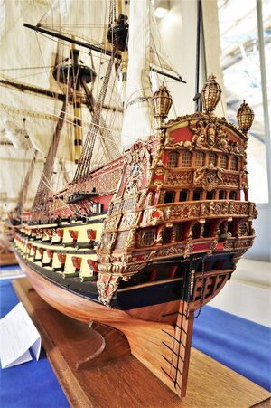

Fore some reasons Corel didn't make 1:1 copy based on Association des Amis du Musée de la Marine plans. I don't know why- there would be conflict for copy rights with Heller, as they did Le Phenix exactly as it schould be. For me all those metal parts from Corel look very poor, so why not scratch build them in proper shape

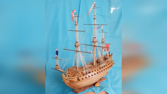

Here's such Phenix, almost all decorations are simplified and scratch-build, but it look far better what comes from Corel

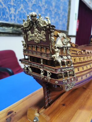

hi, why do you think it looks more like Le Phénix as opposed to Le Soleil Royal?
How are they comperable?
84guns vs 104
2Balconys vs 3
Are side profiles even close?
@Hubac’s Historian is an expert he would for sure elaborate the subject much more (of course, if he wishie so :) ) But baising only on photos it doesn't look comparable

You can say Saint Philippe is close/ish to Soleil Royal
All photos are from SOS forum builds and threads, but I have them catologized be ship name. Sorry for not linking directly to authors
I am not an expert and I am not claiming that the Mirage is the Soleil Royal, but I still do see similarities between the two ships. But then again, what the heck do I know...
Neither am I, but in my opinion there's much more of Le Phenix then SR. Don't take it personally I didn't mean to offend you. There's a huge space between finding photos of alredy made model and making one, which I bearly starting to fill out.

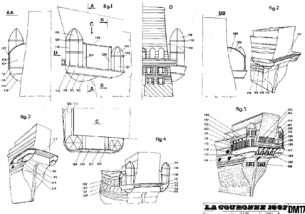

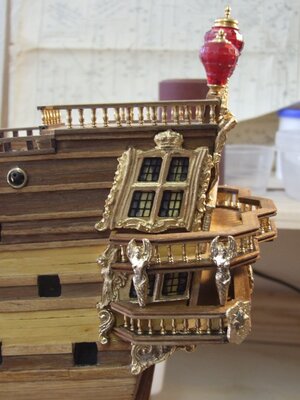

Corel's La Couronne was similar in that the interior was not designed to be viewable or accessible. I had to scratch build the galleries to make them so. They were originally to be made from solid blocks of hexagonal shapes and conical pieces of basswood, and the windows were made from pressed wood pulp, which look okay if painted but are too small and delicate to cut out the areas where the glass would be to replace it with clear plastic or mica. Corel drawings are nice and lend themselves well as guides in scratch building replacement sections of the ship because they had orthographic and isometric views as you can see below.
