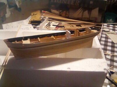

I hardly ever use the frame parts from the kit.
I copy them on a 4/5 mm plywood (according scale) and then cut them with a fine electric saw.
False keel and frames. Then I copy the false cover in 1,2mm plywood and cut it out.
I mark the thickness of the false keel on the deck (4/5mm) and draw it.
With pieces of board I stick them on both sides of the keel mark, between the ribs.
Without gluing anything, I still assemble everything; false keel, wedged between the frame pieces and false deck
I mount everything between brackets nailed to a shipyard between the frames, so that everything is straight and without deviation.
Then I carefully nail the frames to the flat cover starting with the main frame and on one side and the other.
When I see that everything is ok, with a brush and white glue I daub all the joints.
Let dry and repeat several times. Then I put between the frames (without removing from the shipyard), pieces of wood of 10x10mm. sticking them. I let it dry well without hurry and everything is fine most of the time.

I tried to straighten it by extending between ends and putting weight on bow of wood to bend in opposite direction of warp...it did flatten but warp returned. I was hoping to find substitute material stiffer than thin plywood that glues and sands well. I even wonder if getting jig type build cradle will help with warped wood..best bet in my mind is bulkheads and keel made from something that doesn't warp. Just don't know what that is.
Boat half built now but for next time...
