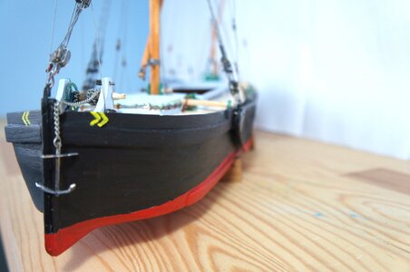

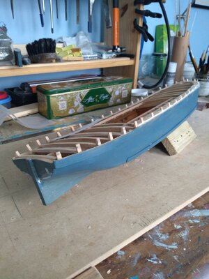

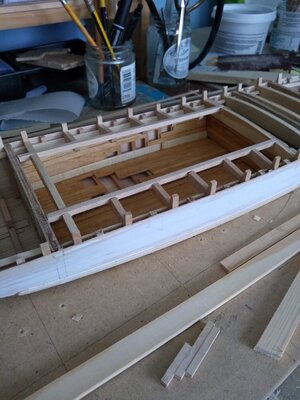

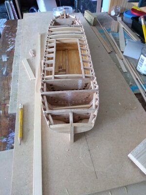

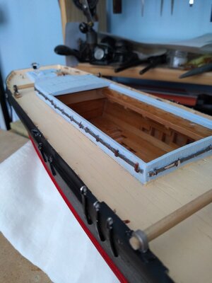

I have received several positive comments concerning the recent completion of my Thames Sailing Barge and a few have asked to see some more pictures. I will try loading some pictures. Not sure how that will go. The barge is genuinely scratch built (I am strictly low budget) and was intended partly as a construction model so that the hold is exposed and some of the ceiling and floor planking is omitted. Most of the model is constructed from recycled timbre. All the fixtures and fittings are fabricated from scrap aluminium or copper wire. Machinery is made from clock parts (big bag of miscellaneous bits bought on the internet). Finally, I must thank my wife for donating a redundant pendant chain which became the anchor chain and hoists for the lee boards! The model is based on a barge called 'Asphodel'. I worked from concept plans and the actual build is based on previous knowledge and various bits of research. Experts will notice that I have made some simplifications and a few departures from the real thing. I hope members will find this of interest.

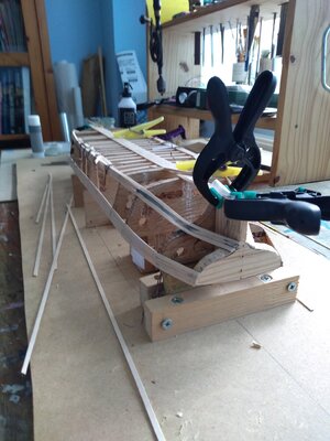

Thanks for showing interest in my Thames Barge. I know what you mean, I probably spent as much time staring at the plans trying to figure what to do as I have actually building the thing! In my case I only had a concept plan of about the right scale so I began by making frames from the cross sections down the length of the hull. These then had to be set up on a base so that they did not move around. You can probably see what I did from the pictures. It worked, more or less, but there were mistakes. I did not have full building plans but luckily I do have personal knowledge of these barges and plenty of research material. I was, therefore, able to put together a construction that was not far from the real thing. I am now scratching my head over lines drawings for a fishing smack.
