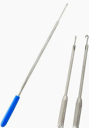

you can also use Binder clips that you get at an office supply store to put weight on lines to keep them straight. There are also little "spring hooks" you can get that are good for both pulling and an end for pushing.
Then there is also a capturing spring hook.
These are spring loaded. The hook comes out of the end when you press on the blue cap and is retracted by the spring as you release the pressure on the cap.

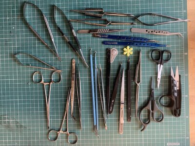

I'm still a relative newcomer to this hobby. So far I've only done the rigging on two models and I'm about to start on my third rigging adventure.
The tools that I used are in the photo below.
A Clipper from my Fly Fishing days
Two DIY tools made from very large sewing needles and a small dowel
Super small scissors for close work
A knot tying tool purchased from Micro-Mark
Jan
Jeff\
Where can i get such spring loaded mini hook.I couldn't find any adress in internet.I have the standard ones without spring which are i use rarely.Normally use long tweezers.The tool you loaded in your thread seems to me being practical .Thanks in advancePirate Flag

I found some on the Amazon web site at:
Spring hook
You can possibly find some more locally sourced by doing a search on the internet for "Capturing spring hook".
