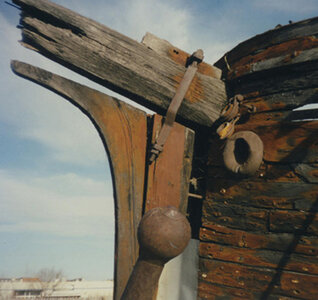

here is a ship wreck of a Great Lakes schooner that did not have a rabbit the ends of the hull planking was nailed to an apron behind the stem.

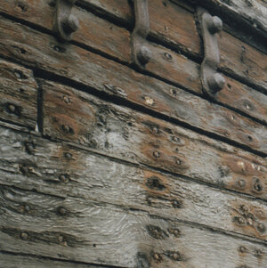

these are not treenails they are iron planking spikes.
