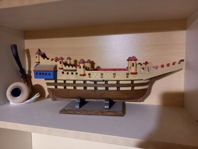

The solid hulls could have the second stage planking applied as usual or one could cheat and simply scribe planks on the solid hull. Clearly this is not an appropriate approach for all models and tastes; a solid dory would look pretty silly! Looking at my current build of the Royal Caroline there is nothing that would preclude this approach below main deck level. For illustration I append a picture of a "great Harry" that I started many years ago and never finished. The hull is shaped from solid oak.
