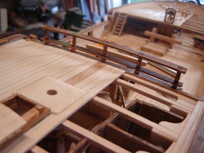

I have made this railing and there is supposed to be sheaves at the bottom of each stanchion where the red arrow(second stanchion from the left) is pointing. I lack the skills needed to install them so I'm wondering about an alternative. Is just drilling a hole my best option?

I drill two holes and then carve a shallow groove between the holes. Gives a decent simulation of sheaves installed in the stanchion base. A dab of black paint in the groove enhances the realism but I find it not really necessary…in fact draws the eye unnecessarily to the stanchion base. Let the imagery remain subtle.

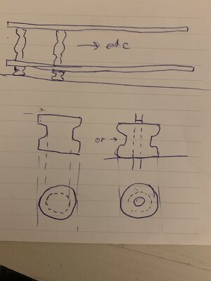

Hi Don
In the attachment i made a simple option how to make the sheaves under the stanchion railing. An alternative instead of drilling holes .
