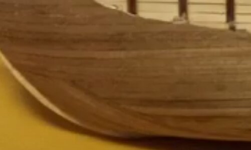

Second stage planking
The hull profile for this ship morphs from that of a pregnant whale amidships to an anorexic sardine at the bow. Bow blocks were used in the first stage to terminate planking at the second bulkhead but are not an option for the second stage: the planking must run from stem to stern. The solution I have adopted is to include drop planks as virtually every other plank. This reduces the number of planks reaching stem and stern and restricts the amount of tapering to an acceptable level at their ends. The ‘approved’ form of drop plank (picture 1) has a blunt end and its neighbouring planks are shaped to receive it. The planking strips in this kit are 4mm wide, 0.5mm thick walnut. These are brittle and the grain is often a bit wild. Cutting away part of the width to receive the end of a drop plank was not appealing. Instead, I simply left the edges of the neighbour planks straight and cut lune shaped drop planks. I.e. with pointed ends.
A common alternative to planking this form of hull is to lay a sequence of planks down from the gunwales until the curve at the bow becomes too severe. Planking resumes upward from the garboard strake and the ends trimmed at an angle where they meet the upper planks. Two of the pictures below illustrate this effect. The slightly fuzzy one is a still from an Amati planking video that shows both a horizontal discontinuity and a diagonal one. Yuk!
I don’t like this option because it leads to a discontinuity in the direction of the grain where the two groups meet. It’s OK if the lower hull is painted white but (personal opinion) I find the result unconvincing. I’m not sure whether this option is used on real ships; if so it is possibly confined to an area very close to the keel. My chosen option has full width planks along most of the length of the hull and the long, pointed taper on the drop planks merges with the continuous planks gradually with no blatant change of grain direction.
The final picture is my completed hull. It is not quite as I would like because of the restrictions encountered when trying to smooth out the joints between first stage planks. I hope the wales and fenders will distract the eye from some blemishes and the rest will disappear under the hull when to is mounted. I must remember to minimize the height of the supports on the display base.
