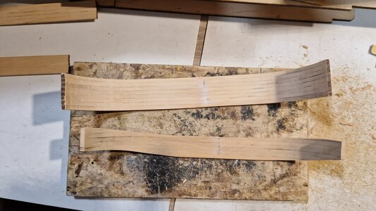

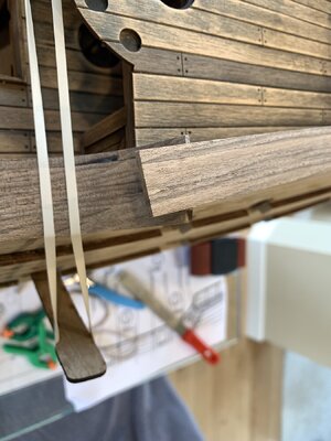

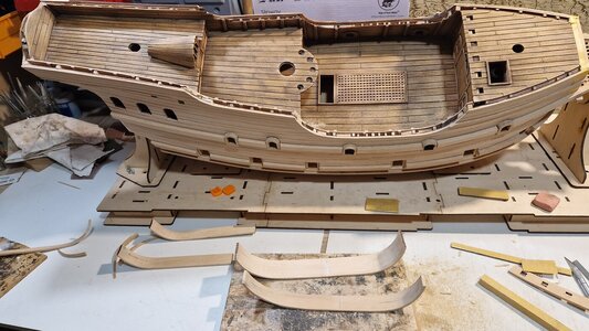

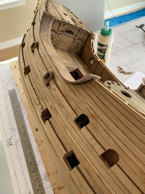

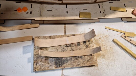

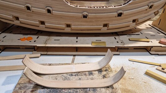

I am a year and a half into this project having benefited along the way by following your excellent build logs. Many thanks to all. My kit is planked. I built the bulwark caps and am attempting to attach them. Is the additional width of the lower cap intended for sacrificial width shaping to accommodate the hull shape?
In the photo below the cap rails are sitting unattached to illustrate the difference in widths.

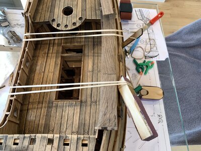

1. How have you dealt with the width differences
2. How did you clamp the rails in place for the glue up. Photos of how to hold in place?

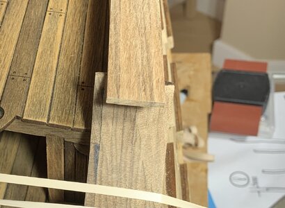

In the both photos it can be seen that the top cap is narrower than the lower cap. Is the extra width of the lower cap intended to be sacrificial to accommodate the shape of the hull?

I think I understand what's going on. This wide part needs to be made narrow using a knife and sandpaper and bent to the shape of the side. You see, the side of the ship is not straight (if you look at the ship from above), so they allowed you to make this part with a margin so that the part could be removed. As a last resort, you can write to Pavel Nikitin and find out how this can be done. By the way, were you sent instructions by email?

You must first shape the board by placing it on top of the gunwale and marking with a pencil underneath, following the line of the hull, and then using a file to cut it to the appropriate shape.

Dave, thank you. Your suggestion is exactly what I guessed but thought it best to ask advice to confirm. I have been intentionally staying behind the several build logs and You Tube video to benefit from their experiences and in this case I was unable to find someone who described the process. This is a nice photo that demonstrates the result.
