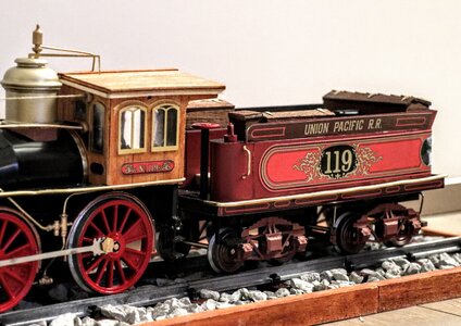

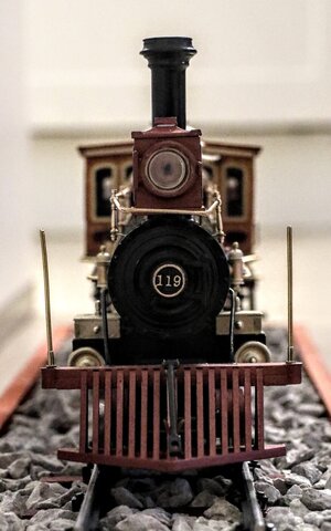

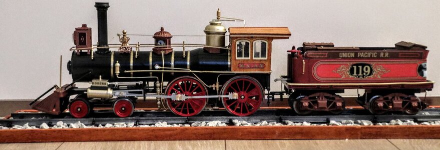

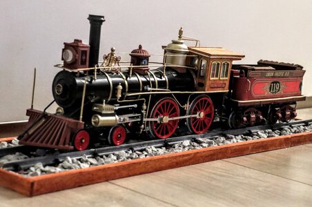

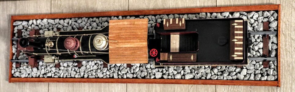

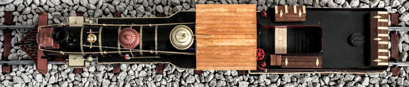

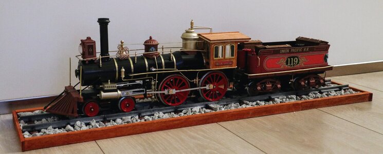

This train I made during the Corona pandemic, therefore I called it the Corona Express.
The kit is tricky to make, especially the metal tubing. The paint kept jumping off at the glued parts despite using a primer.
I did not like the original bright red for everything, therefore I only used it for the wheels and for the rest I used a Crimson red mixed with silver.

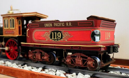

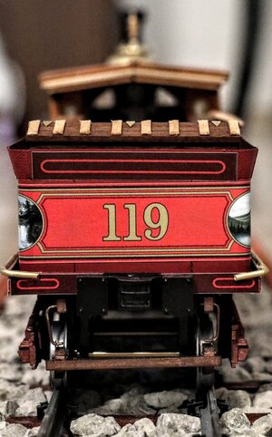

Fantastic job. The numbers on the side and back of coal car are amazing. How did you do them? Please help us
Thank you for your kind words. The numbers are stickers that came with the kit. After applying them, I coated them with a top coat to give everything the same level of gloss.

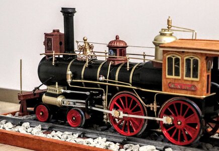

If you didn’t make or post a build log, please share your secret: How did you attach the “boiler side” metals to the wooden forms? I’ve encountered this type of issue before (bonding metal to wood), but have never found a good solution. Even when the mating metal is roughened (sandpapered), the adhesives will not always hold. I hope your method works for all of the commonly used hobby metals.
Bonding the metal boiler plates to the wooden frame is indeed not straightforward. What I did, was to drill small holes at the corners of the plates and nailed it to the frame. The golden strip between the plates cover the nails.
Any dents in the metal can be removed by a filler.
