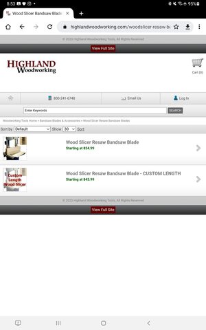

As mentioned by others, consider milling it down a bit before resawing. I'd rip it lengthwise in half. Question: does your bandsaw have the riser block installed? Next - the blade. Use carbide tipped bandsaw blade for resawing if you can. It'll be easier to resaw with. This saw has the riser block installed and a resaw blade installed also.
