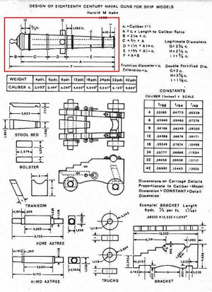

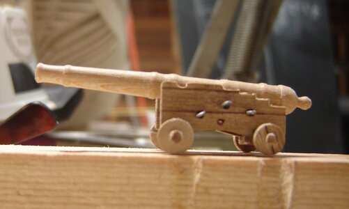

This is for anyone that has seen one of these cannons. How big were the reinforcing rings? How wide and how much proud of the barrel? Just ball park numbers are good enough. I'm just trying to figure out if I've made mine a tad largeDSC04535.JPG
This is for anyone that has seen one of these cannons. How big were the reinforcing rings? How wide and how much proud of the barrel? Just ball park numbers are good enough. I'm just trying to figure out if I've made mine a tad largeView attachment 303130
Hello, Don.
This document should guide you, and give an idea about proportions, and sizes in relation to scale.
Thanks Jimsky. That's the drawing I've been working from. I just wasn't sure what the bands actually looked like but they're done now, I'll live with them.

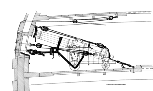

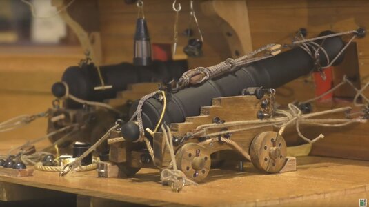

I'm looking at the rigging on the second picture you posted, can you tell me more about it. It doesn't look very convenient for shooting.
Hello, Don. This type of rigging is common to guns on a long sea voyage (not ready for action). Usually, in a ruff sea or just en route to the destination.

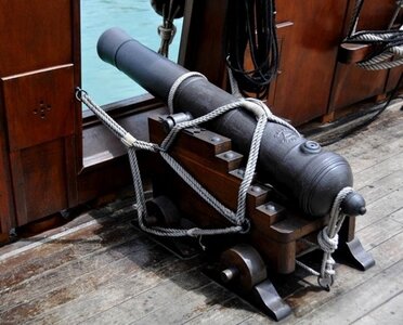

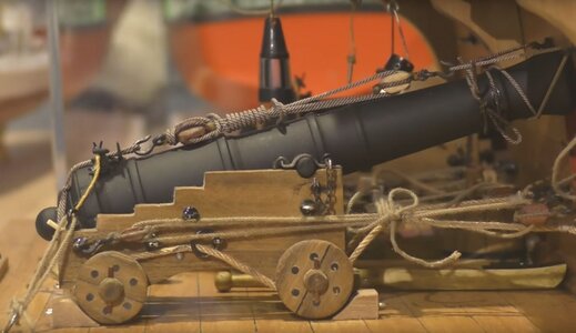

here is another example
Like maybe sailing around the world to get from England to the west coast of North America for a diplomatic/survey trip? That would sure save me a lot of rigging tackles.:) So it's possible they could have had the guns on the Discovery1789 rigged like this for the whole trip. Did they ever turn the guns sideways and push them up against the bulwarks? Something in the back of my head says I've seen this. What did they use for signaling? Swivel guns? Discovery had ten of them.

Usually the guns were fixed in such a way like Jim showed, and this during the complete journey - there was every time the possibility of fast changing weather conditions or a big wave, so therefore not enough time to secure the guns.
Only when there was gun drill and exercise to get "ready for action" or off course "action" the tackling was changed.

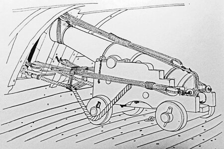

taken from Boudriot 74-gun ship Vol IV page 122

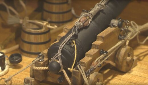

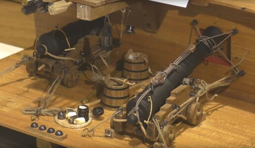

Here a beautiful model of a battle station
I guess there were different ways with the ropes and tackles possible and used
also different levels of securing from light to strong "temporary secured", "secured with double lashings" and "gun housed against the clamp" which is shown in the sketch and the model

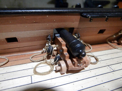

Parallel to the bulwarks the guns were only turned, if there was not enough space - you have to imagine that the bigger guns had up to 1,5 tons weight
Jean Boudriot is writing:
As a final point I should mention in passing securing the guns alongside, which consists of making them fast fore- and aft against the ship´s side, breech resting on the sole of the carriage; this somewhat unusual arrangement may be employed on occasion in order to provise more room on the gun decks, such as for example when the ship is fitted out as a troop ship.
