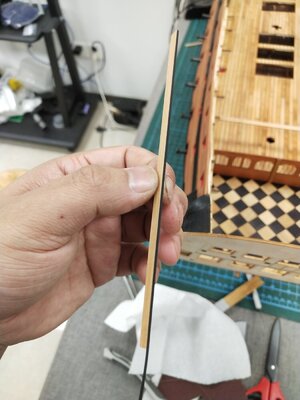

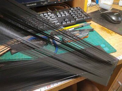

PVC Plank Gap filler
I haven't used it, but I'm only on my second wooden ship build. on the first build I used very fine black thread but it was a pain and very fiddly. I got lazy on the deck of my current ship and simply darkened the edges of the deck planks with a 'Sharpie' indelible pen.when glued in place it gives a nice thin black 'tar' line.
I agree a sharpie is probably the way to go The filler planks would work great but the cost is expensive around $35 for 350 pcs at 12" long? Plus shipping
The sharpie works good!
Thanks
Thanks
Beware the Sharpie if you plan to stain the deck. The black might run. Much safer is a black permanent laundry marker available ion sewing or craft stores.
I have used a carpenter pencil which can be purchased at most building supply stores. The line is a dark grey and looks good. I have had trouble with Sharpies as the ink can bleed in to the deck surface.
