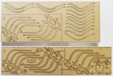

The jigs I was referring to (provided with Alert kit) are made from MDF board (take a look the image below)

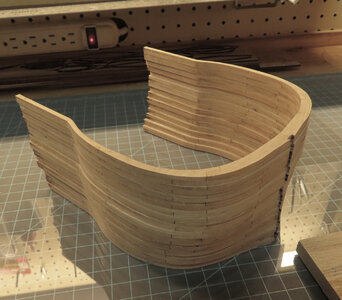

Jig in action (from @shota70 build log)

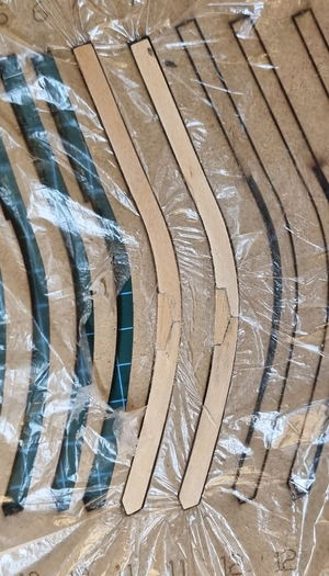

photo taken from Donnies building log
