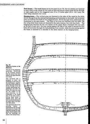

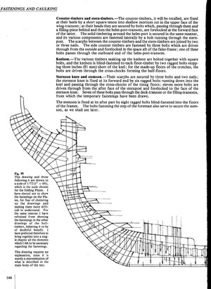

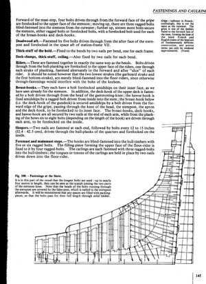

Good evening, in the doubt that bolts were used in shipbuilding, specifically the axial carpentry is cited by Boudriot and also from English source "Pins. '"These too are iron bars with a round or square section, but of variable thickness from one end to the other, decreasing from the head to the point. The pins are made to measure: in our vessel, the longest touch 12 feet (390 m), with the diameter greater than 5 cm and the smaller diameter 4 cm. The diameters of the pins vary from line to line (2.25 mm); in our vessel, the larger diameter of the smaller pins is 1 inch ( 27 mm) The head of the pins is relatively little pronounced, being rather a slight bulge of the stem."

The bolts on the BH and similar ships were normally not threaded, and AFAIK, not "nuts" (square or hex) were used. Most were clenched in some way, bending over the end of the bolt, or a keeper driven crosswise through a slot in the end of the bolt, or other end attachment. The "bolts" then were not that dissimilar to "nails" except in size. Some, as shown above in the long bolts into the keel, were more "screws" in today's terminology, as I believe they had threads at the end only, to screw into the wood, rather than nuts or attachments at the end.
Frank,
Very good detailed description and drawings.
What book did this come from?
from the first volume

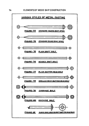

1646663994443.pngGood afternoon Signet, this is one of many vintage tables
This gives a pretty good overview of the subject, making it clear nuts and bolts go WAY back....
