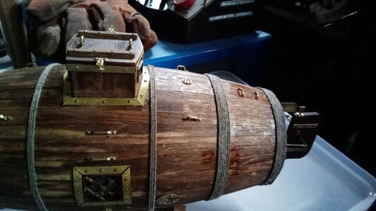

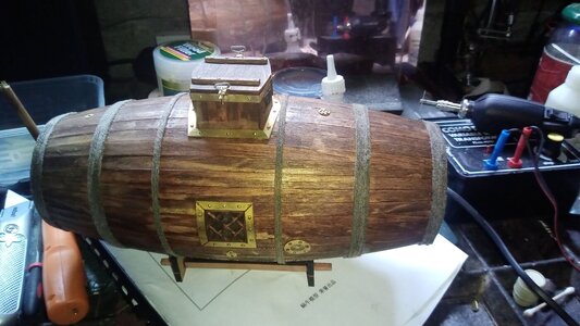

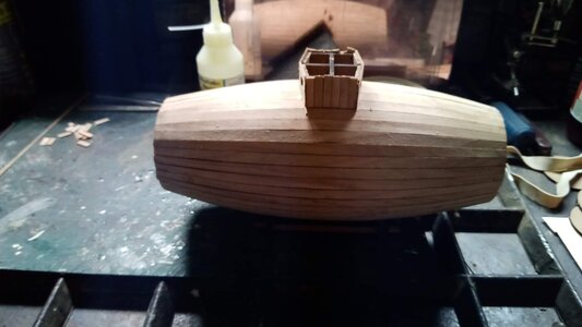

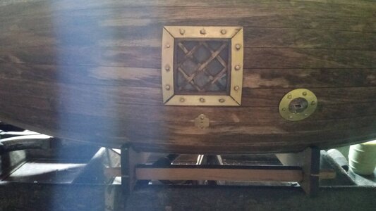

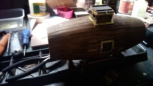

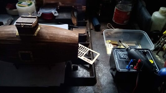

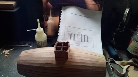

IMG_20230625_122859_7.jpgThe basic beer barrel, as I call it, completed with the turret attached. No real problems as the resin glue I used is strong, has a good tack quality and a fairly quick drying time. I've also got some good rubber bands to hold things in place!

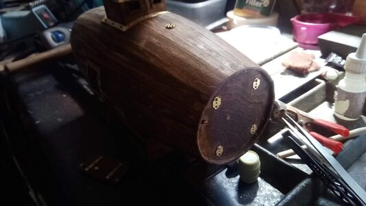

The brass trim taking shape. A dab of superglue and then bucket loads of pin 'rivets'. Each hole predrilled and the pins tapped in.
I've also fitted the 'glass' windows. Tricky but do-able.

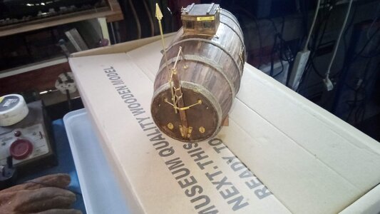

The finish is wood scratch remover (dark oak flavour) and I will give it all an oak wax final finish. I havent decided on weathering the brass yet. I quite like it as it is.
The rudder completed. The rivets were a real pain. Chopping the pins, pre drilling the holes and sticking the bloody things in was no fun!

The Manual. HA HA!

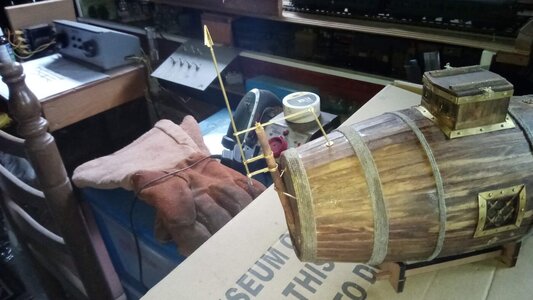

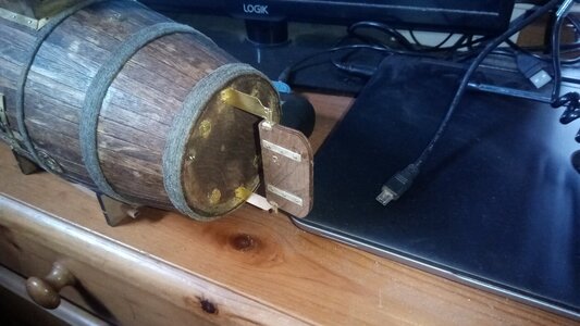

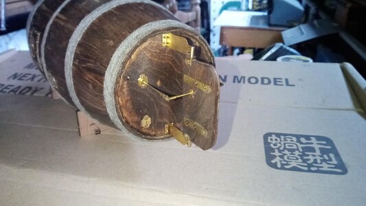

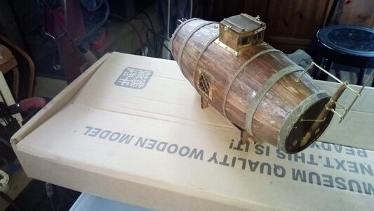

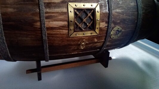

Wrapping done and stained and the harpoon pole on. IMG_20230710_140557_7.jpgIMG_20230710_145522_7.jpgIMG_20230710_145746_2.jpg

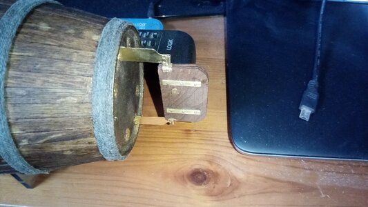

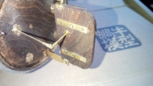

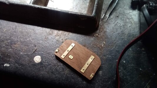

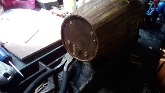

The rudder mounted but not quite finished!

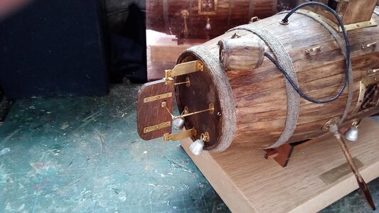

I've finished the rudder and its linkage. It does actually work, having mastered the art of drilling the tubing and flattening the ends. Cut the brass rod to length, glue the drilled tubing on and link up with a pin.
If you had studied my previous pics, you will spot my deliberate mistake (or one of them at least!) I had mounted the brass linkage ports in the hull too high. I hadn't studied the manual properly, got the ends confused, and my arse kicked!
Easy job? -NOT!

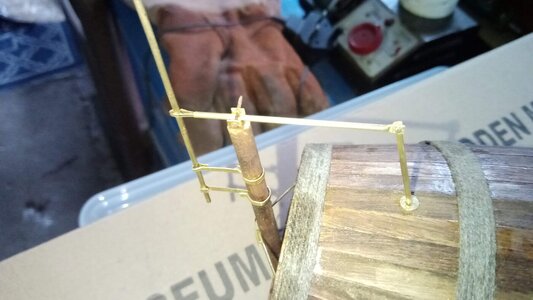

The harpoon is somehow together and I'm working on the linkage for that. Fiddly or what!

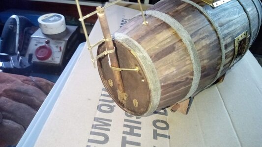

IMG_20230715_132015_4.jpgIMG_20230715_131931_9.jpgIMG_20230715_131942_1.jpgIMG_20230715_131951_2.jpgIMG_20230715_132024_5.jpgIMG_20230715_132057_9.jpgIMG_20230715_132001_4.jpg

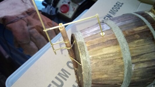

These pictures are of the basically complete model. The harpoon is fitted. Its supports were a bitch to bend to shape. You can probably tell!
I had to study the 'manual' to get the final bit of the linkage that attaches to the harpoon right. If you look, you can see why.

A few lessons learnt and, maybe tips. Don't stain the hull before fitting the brass. Superglue doesn't like it! Use square-nose pliers to crimp the tubing.
I did use superglue to put the brass, the rudder and harpoon mechanism together, because it bonds quickly -when it decides to! Use good quality glue too, if you value your sanity.
A tip for making the air barrel. Soak the wooden planks first. They break VERY easily.
The model came out OK and I'm pleased with the result so far. Very intricate and a bit fiddly, but do-able with patience (It took me a week to make the air barrel! Inch by inch, glueing the thing together, plank by plank and clamping each time.).
Tweezers, clamps or rubber bands, scalpels, and a pin vise are vital, as are the right drill bits. A Dremel is also worth its weight in gold.
I hope those contemplating building this unique model will find my log of my efforts useful. If I can make this kit, anyone can! The manual wasn't a problem in the end. It is well laid out and with a bit of common sense, you can figure out what to do. Mind you, for the cost of the kit, they should provide an english translation

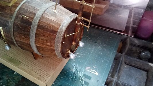

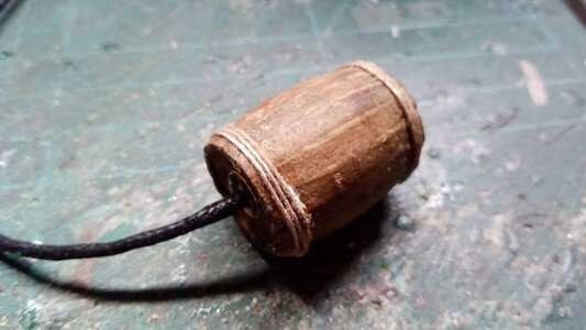

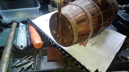

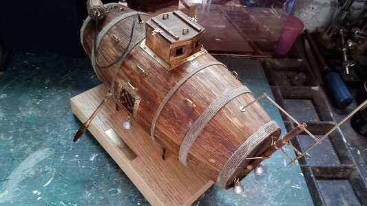

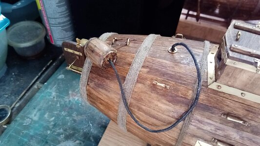

The following snaps include the ladder rungs and air barrel and barrel mount. The weight irons are also fitted.
IMG_20230718_145630_1.jpgIMG_20230718_142133_7.jpgIMG_20230718_141221_6.jpgIMG_20230718_141159_0.jpgIMG_20230718_141144_9.jpgIMG_20230718_141117_9.jpg

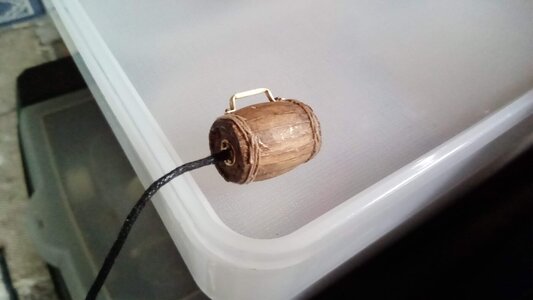

The air barrel with the securing handle fitted, but the wrapping needs tidying.
You cant make too many mistakes with the tubing supplied for the kit to make these rungs, etc.. There is enough, but not a lot spare
I found a Dremel with a VERY small bit was needed to drill all those 'rivet' holes for the rungs. Marking the holes was essential. I needed a lot of patience too!
Just the oars and weights to fit, the barrel and hose to mount, and the end is in sight!

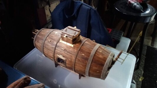

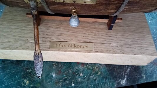

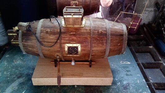

The final pics of the build so far. The sub is now complete and mounted on a polished piece of oak offcut.
I may add the tethering ropes when I get to it, but they are not shown in the manual so they are an extra as far as I am concerned.
It probably isn't finished. They never are, but it will do for now.
Please let me know what you think. I welcome constructive criticism!IMG_20230719_170955_4.jpgIMG_20230719_171000_7.jpgIMG_20230719_171008_1.jpgIMG_20230719_171016_6.jpgIMG_20230719_171037_9.jpgIMG_20230719_171050_0.jpg

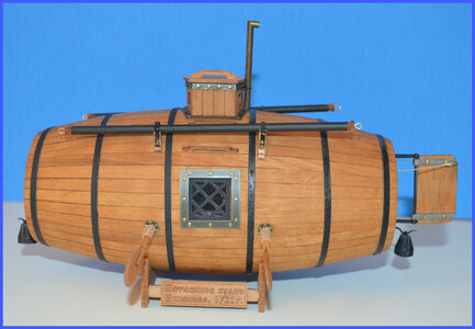

On the Master Korabel version, what's the purpose of the two black tubes with the eyebolts in the ends, to either side of the pilot house?
Sorry, can't help. It was another contributer who posted.
Thanks anyway. I love your model, by the way. It reminds me of the literally fantastic Steam Punk creations, that are pure alternate universe contraptions of a re- imagined Victorian industrial age technology: iron, brass and steam contraptions, aero nautical, nautical, and anything else you can think up. Jules Verne and H. G. Wells, I believe, being the inspiration. If you want to see some beautiful and exquisitely executed models check Steam Punk out! Yours is unequivocally an exquisite little masterpiece! Okay Thumbsup
