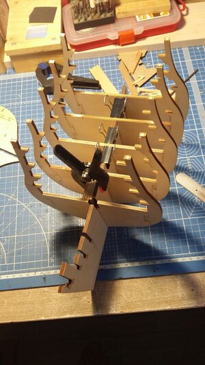

I am starting a new project. The same customer provided me with a job again.
This will be the VICTORI model by Deagostini magazines.
The project is long-term, therefore, for a long time.
I will try to make a decent model out of it.

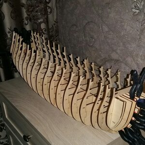

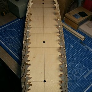

Then let's continue: I assembled the frame. I installed all the frames on the keel frame and laid the first false deck. There is no need to do flooring on it, because it will not be visible at all. Ahead of me, according to the plan, is filling the space with linden bars. As it turned out in Moscow, it is not so easy to find linden boards on the construction market. But I was lucky. There is a lot of work ahead.IMG_20210805_211828_078.jpg
In this photo below, you can see that the keel is slightly curved. But this is due to the lack of rigidity of this design.
After installing the false deck, the hull became stronger.
Great start, Sasha. I don't know if it is the image angle or shadows, but, I hate to say, keelplate looks bent.
Genaro, it is. I wrote about this in a post right above the photo. The hull is long and the keel frame is loose. After installing the deck, it leveled off. And in addition to this, I will fill in the spacing with linden bars. So there will be no curvature in the future.
