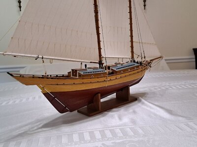

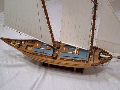

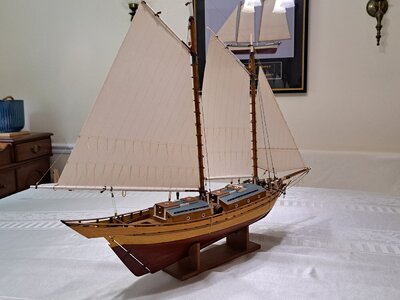

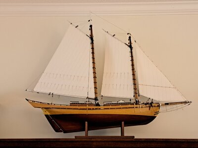

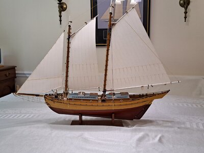

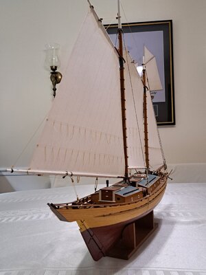

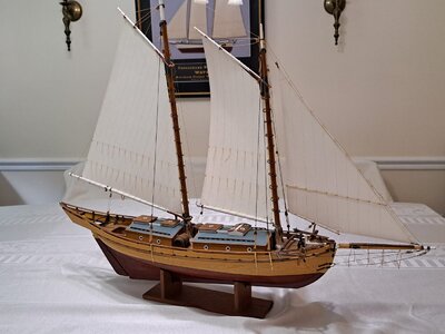

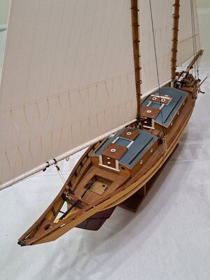

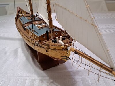

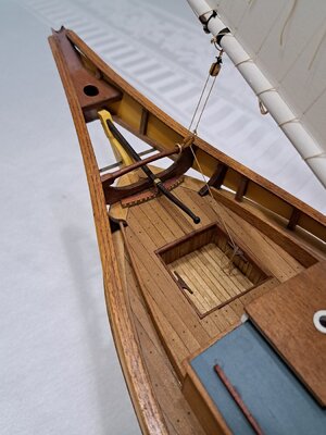

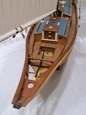

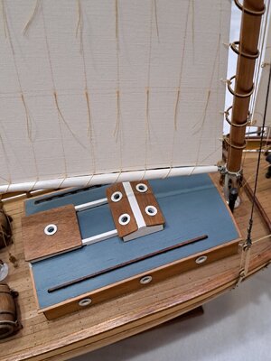

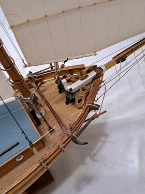

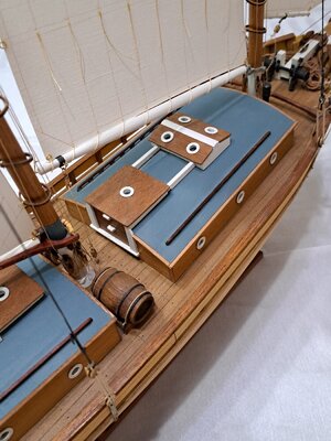

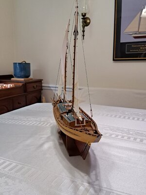

This kit comes with its own set of unique challenges; eg. Two rows of little stanchions that have to be glued into little notches in the deck at juuuust the right angle to recieve the "floating" bulwarks. this is critical to being able to fit the "flying 'tombstone' transom" between the tail ends of the bulwarks where they come together overhanging the stern. Then the bulwarks have to be bent and twisted outward to receive the "tombstone" which is held in place (hopefully) by the springiness of the bulwarks. This took a bit of careful sanding and repeated fitting until the tombstone would fit snugly in place. A reeeeealy fiddley bit of work!
The sides and bulwarks are over planked with Tanganika strip wood (veneer) "pickled" (wiped on , wiped off) with yellow ochre acrylic. Below the waterline is Mahogany strip "20230707_144440.jpg20230707_144542.jpg20230707_144634.jpg20230707_144650.jpg20230707_144708.jpg20230707_144722.jpg20230707_144727.jpg20230707_144751.jpg20230707_144831.jpg20230707_145324.jpg20230707_145425.jpg20230707_150638.jpg20230707_150731.jpg20230707_151537.jpgPickled" with red acrylic. The tiller and travelers are carved from Indian Rosewood. the deck is Lime. The sails are artist's canvas paper.
A very fine ship and a well and accurate build model - BRAVO
The sides and bulwarks are over planked with Tanganika strip wood (veneer) "pickled" (wiped on , wiped off) with yellow ochre acrylic. Below the waterline is Mahogany strip "View attachment 383495View attachment 383496View attachment 383497View attachment 383498View attachment 383500View attachment 383501View attachment 383502View attachment 383503View attachment 383505View attachment 383506View attachment 383508View attachment 383509View attachment 383510View attachment 383512Pickled" with red acrylic. The tiller and travelers are carved from Indian Rosewood. the deck is Lime. The sails are artist's canvas p
The sides and bulwarks are over planked with Tanganika strip wood (veneer) "pickled" (wiped on , wiped off) with yellow ochre acrylic. Below the waterline is Mahogany strip "View attachment 383495View attachment 383496View attachment 383497View attachment 383498View attachment 383500View attachment 383501View attachment 383502View attachment 383503View attachment 383505View attachment 383506View attachment 383508View attachment 383509View attachment 383510View attachment 383512Pickled" with red acrylic. The tiller and travelers are carved from Indian Rosewood. the deck is Lime. The sails are artist's canvas paper.
