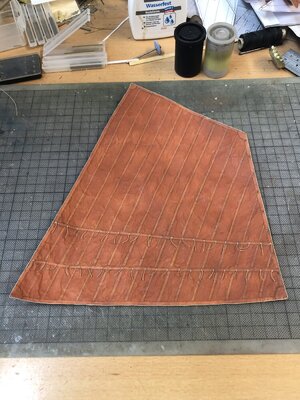

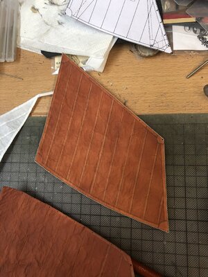

After some considerarion I decided to make it like the real sailmakers, in lanes.
The markings are recorded on the double-layered clothes, where they are laid on top of each other an glued together with a glue-water mixture.Gaffelschalup_20201020_2.jpg

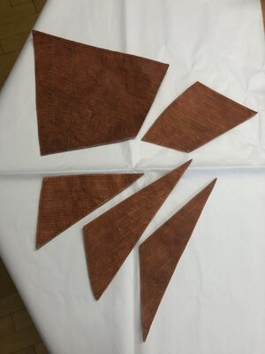

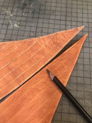

The contours of the sails are cut out using a template, with duplications on all sides and reinforcements at the end. Then painted with airbrush. Be careful, the sails are vey sensitive when they are wet. When dry, they are very stable.Gaffelschalup_20201020_4.jpgGaffelschalup_20201020_3.jpg

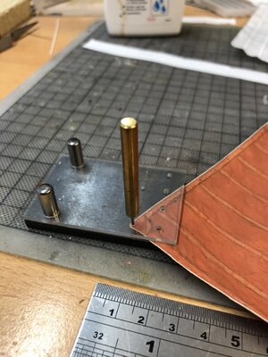

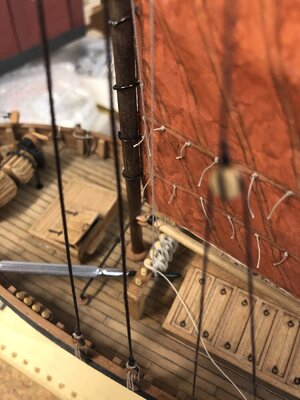

After painting the sails they get a bolt-rope and the necessary holes are punched with punch and die set.Gaffelschalup_20201020_6.jpg

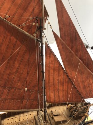

Then the sails are treated with a weathering pencil to get a natural look.Gaffelschalup_20201104_2.jpg
At the end the gaff sail gets the necessary reef straps.

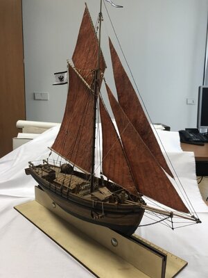

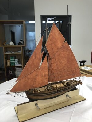

Of course I'm not quite satisfied yet, because it still has too many wrinkles, but I'm still working on that.
To be continued.
The sails are looking great - wow -> very realistic

Might I ask where you got the punch tools and die for making such small holes so easy?
Hi Kurt, the punch and die set I purchased from a German plastic modeling company and is from Italy. Unfortunately it is no longer available. But there is something comparable from RP Toolz with hole width from 0,5 to 2 mm and is available in the relevant plastic modeling trade.
