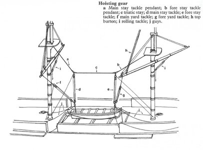

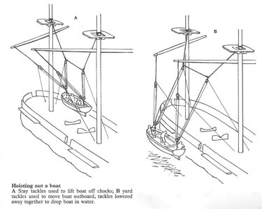

I am working on the 2 small boats positioned on the mid ship deck my question I see no rigging to lift the boats up and over the rail and into the water? should there be? and if so, where does this rigging go?
Hi; from what I have read and seen, they would ropes with pullies located at the yards' ends of the fore, and main masts which would be pulled, attached, then with the help of crews lifted and directed by them to the side, then slid on the hull's side vertical protective beams down to the water; the canoes' positions in the ships varied a lot with the ships...
Such rigging was almost always stood down when not needed thus rarely seen in models. A lot of working rigging was temporary in this way. But you can model it by finding belay points on the masts and attaching block and tackle rigs to the boats. Some research will provide how this is done…maybe a forum member has an example at hand…

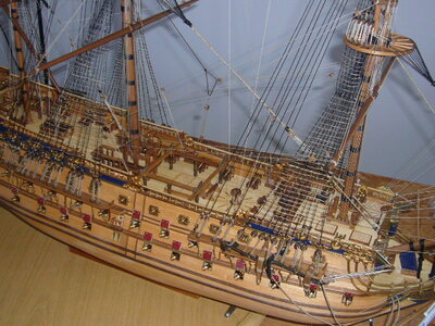

The only model kit I've seen something like than on is Panart's San Felipe and I have to believe that Jim's comment about standing down the rigging when not needed is spot on. The San Felipe set up has lines from the foremast and main mast supporting a block and tackle. See attached picture--boats weren't installed at that point. If you want to try something like this I can send you a pic of the plans.

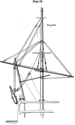

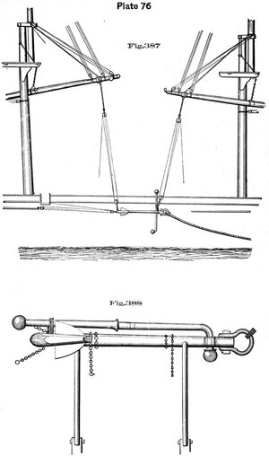

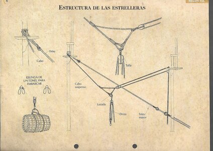

for all lifting activities on such a ship f.e. loading water barrels, guns / muzzles etc. they used tackles and the yard arms
At these times the ships had no other lifting devices or cranes, derricks or what so ever
View attachment 345459 View attachment 345460
