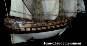

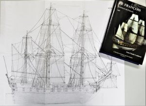

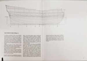

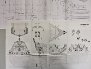

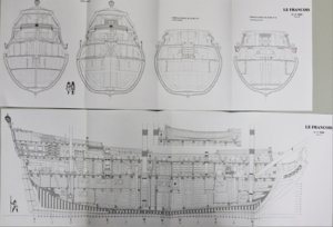

Planset Review:
LE FRANCOIS
5th class vessels
built in Toulon 1683
(from a manuscript by François Coulomb)
by J.C. LEMINEUR

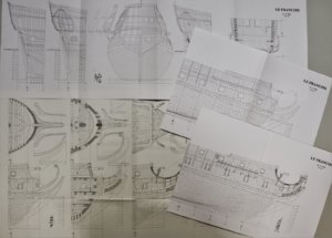

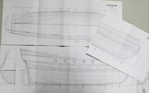

Planset in scale 1:48 is available at ancre in french, italian or spanish language. An english version is planned.
Also available is the planset in scale 1:36

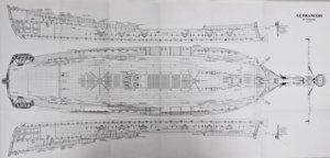

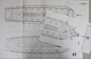

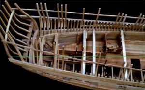

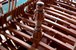

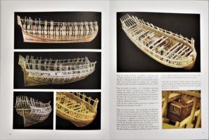

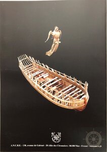

Analysis of the photographs of three models of the ‘François’ during construction completes this information.
Model-makers thus have complete and particularly detailed documentation on ‘LE FRANCOIS’, a small 5th class vessel in Colbert’s navy.

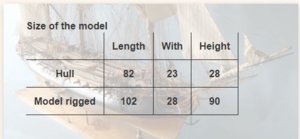

Size of the finished model:
Content: left the booklet and on the right the drawings / plates

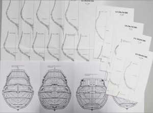

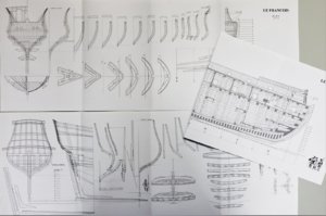

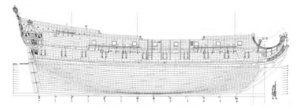

LIST OF SCALE PLATES
List of 1/48th scale plates comprising the construction drawings.
Schematic line plans
1. Schematic vertical line elevation
2. Schematic plan view
Construction
3. Timbered elevation
4. Stern construction
5. Bow construction
6. Longitudinal section
7. Transverse sections
8. Profiles of forward frames 1 to 16
9. Profiles of forward frames 17 to 35
10. Profiles of aft frames from midship beam to 15
11. Profiles of aft frames 16 to 29
12. Profiles of aft frames 30 to 40
13. Horizontal section under the false beams
14. Horizontal section under the 1st deck beams
15. 1st deck construction
16. 2nd deck construction
17. Poop construction
Interior layout and rigging
18. Head construction and stern layout
19. Transom and officers’ head construction
20. Planked elevation
21. Decorated elevation
22. Longitudinal section of the layout
23. Transverse sections of the layout
24. Plan of 1st deck
25. Plan of 2nd deck
26. Plans of poop
Decoration and equipment
27. Bow and poop decorations
28. Equipment and launch
29. Equipment and artillery
30. Mainmast
31. Foremast
32. Mizzen mast and bowsprit
Sails
33. Mainmast sails
34. Foremast sails
35. Mizzen mast sails
36. Additional sails
Rigging
37. Rigging details

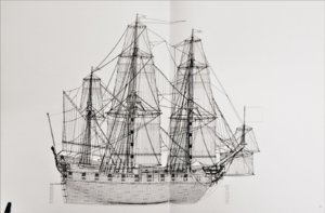

38. Large elevation under sail (1/72 scale)

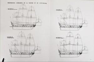

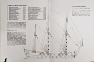

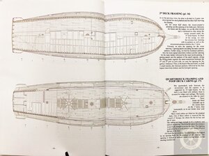

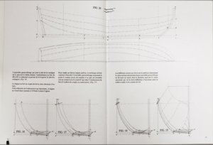

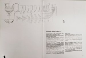

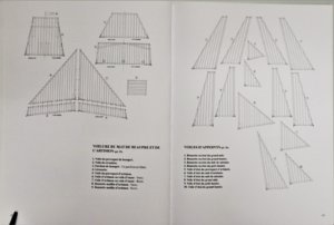

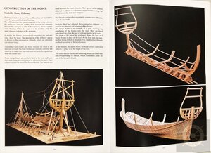

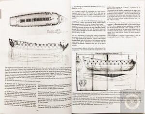

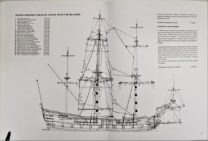

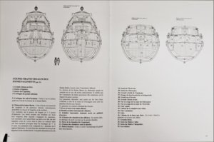

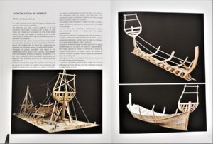

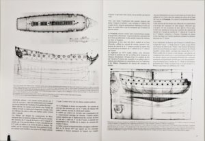

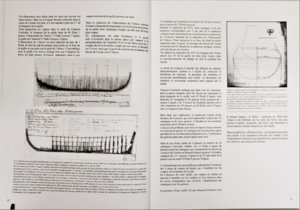

Look Inside of the Booklet:
Every single drawing is explained in the booklet - so very helpful
to be continued in the following post .....

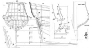

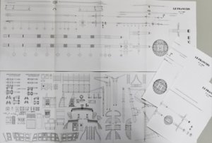

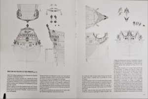

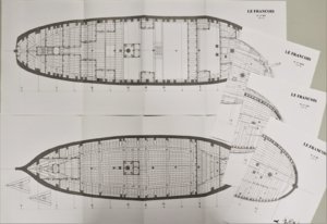

Look Inside Drawings

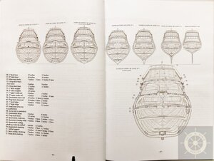

Hallo my friends and friends of the ancre publications!
Today I am able to show you the english version of the booklet, which I got recently from Didier berti from ancre - Many Thanks
Now the Planset is available from ancre either in English, French, Italian or Spanish language
As mentioned earlier the english translation was done by our friend and member @Gilles Korent - BTW: The Francois is one of my favourite ships from ancre
