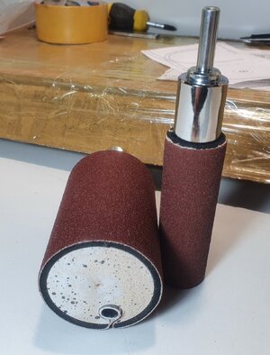

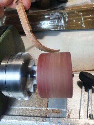

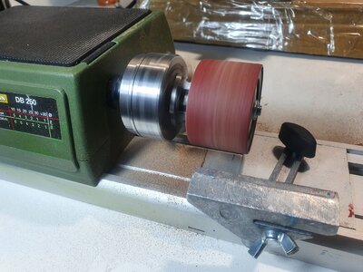

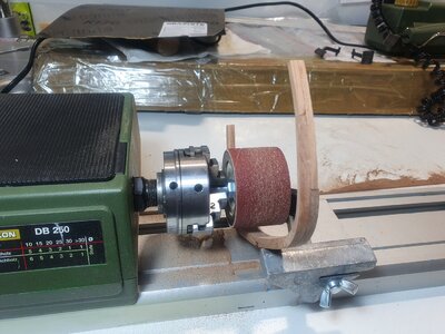

Hello. I will share my patent. Today I accidentally used a grinding drum for a lathe. The 45mm diameter drum does not damage frames and sands flat and rounded surfaces thoroughly. A very interesting solution for grinding. You can precisely adjust the speed, much better than on a drill. You can also rest the frame on the stand. The effect is satisfactory. Slow speed, less noise, easy to clean and grind. I recommend this.
This is my second drum from the hardware store, some German "Wolfcraft". The first cheaper one also wobbling when I tightened it hard. This one works stably for now, I have made today some frames on it. I guess it depends on how you get it.
It's definitely better to grind than with a drill, and it's more comfortable.

Thank you for the tip, bearings are clean. Proxxon has two bearings and a chamber between them and the engine, and additionally a clamp around the engine axis, nothing can get there. Dust falls onto bottom rail by gravity. I've been using a vacuum cleaner from time to time to clean what is on the table. I'm more afraid of pneumoconiosis than of the lathe o_O

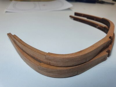

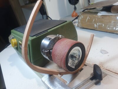

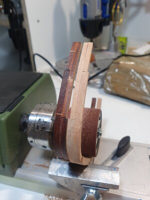

"Necessity is the Mother of invention." I really like this idea. My first thought was :oops:o_O, thinking how does he keep the pieces square so the edges aren't damaged. Then I saw the piece being held on the tool holder. Is that how you keep the frame square while you remove the char? Your finished frame is very clean with very little material removed and with sharp edges. Very, nice work indeed.

It's a matter of learning, I half destroy first frame.
Proxxon is small, two hands can rest comfortably on the table. You need to rest your hand well when sanding on the outside and rest the frame on the handle when cleaning inside. You have to do it confidently. I have made 12 frames so far, I still leave some lines for sanding with a sanding block. The engine speed is very low and the material is slowly removed with 150 or 180 grit paper. It is such a slow process that you can precisely remove a small layer. I also do rounding, it's just a test for now, but the idea is good. What can't be removed with the drum, I clean PS13 with paper stuck on the tape. You cannot clean flat elements on a lathe, it must be a rounded surface.
