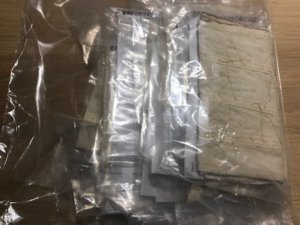

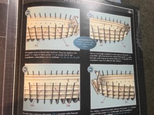

Part One:Instructions
As I have just stated,English instructions were never produced.The instructions are included in each weekly part.There are many step by step instructions with photographs of the actual model.This is very much standard Artesania Latina fair(the manufacturer of this partwork).There is no full size plan of the model,with dimensions illustrated in the photographic steps.What is different to normal Artesania instructions is the depth as which they go in to.We have 120 issues with 6 pages of instructions in each.This is equivalent to a 720 page instruction manual!The intention is that,as with all partworks,that this model can be built by a complete novice.To be honest,I beg to differ on this one.This is a VERY complex and detailed model.
I have taken some sample pictures of the instructions.

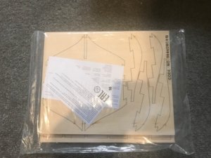

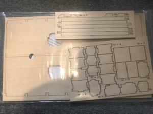

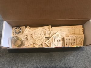

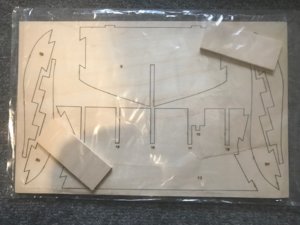

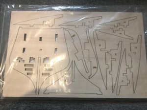

Part Two:Sheet Materials.
All sheet material is Plywood of various thicknesses.Everything is fully laser cut.The False Keel is in four sections and all bulkheads are made up of three sections.This is due to the fact that everything must be packed into an A4 size envelope to be posted to the purchaser on a weekly/subscription basis.
The False Keel and bulkheads are only 4mm Ply but due to the complex skeleton,I have no concerns over strength although care will have to be taken pushing planking pins in.
The gun carriages are laser cut from plywood unfortunately,replacement with scratchbuilt solid wood items is possible but these things are small.They may not look so bad with a dark stain on.
I have included some pics but keep in mind there is an absolute mountain of precut frets,these are just some examples.
Kind Regards
Nigel

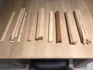

Part Three:Stripwood
Again the fact that this is a Partwork means that all timber is supplied in 300mm lengths.
The first planking comprises of 2mm by 5mm Birch.I have never used this before so it will be a new experience.Apparently it bends well but is a hard timber when it comes to cutting and sanding.
The second planking consists of 0.5mm by 5mm Sapele for below the waterline and the same size basswood for above.5mm is way above what scale planks should be so if you are going for a natural finish and are keen on accuracy narrower planking needs to be sourced.
The deck planking is 0.5mm by 3mm Beech.Again overscale,scale width on this vessel is 1.5mm.Yes I am a gluton for punishment,when I do build the model I will try to get as close to 1.5mm with the deck planks as possible.
Untapered dowels in Birch I include for the masts and yards.
Finally there is a mass of various size stripwood for the remainder.Many in odd sizes to suit the application.Veneer calipers essential to ensure the right piece is used for the location.

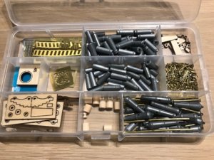

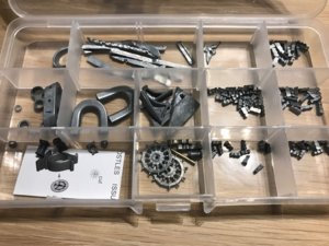

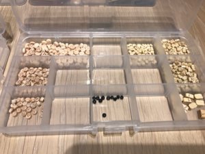

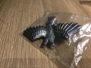

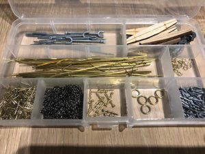

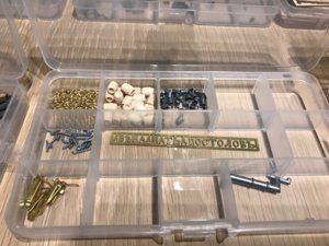

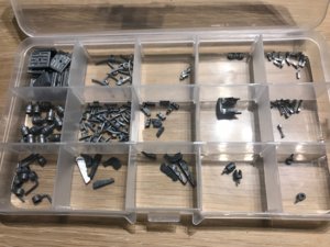

Part Four: Fittings
I spent a total of 7 hours just to sort the fittings and photoetch out for this Partwork into storage boxes.There is a plethora of purpose made,not generic castings,for this model.Even the cannons are a one off for this model and are accurate.The lower decks are all blind barrels the main deck are full.
The simply massive figurehead is accurate for the model and is in four sections,the lower limbs and crown are separate parts so not to compromise on detail.
The rigging blocks are standard fair but the deadeyes are scale size and the smallest,I think,are smaller than any commercially available.
Biggest let down is gratings and stairs,these are the standard oversize fair and to be honest,in comparison with the rest of the model,garbage!
Note the nice photoetch Cyrillic name for the stern in individual letters.
Kind Regards
Nigel

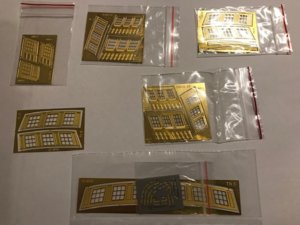

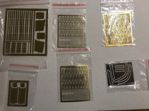

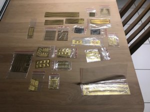

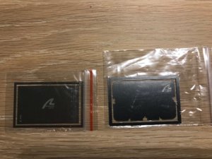

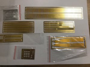

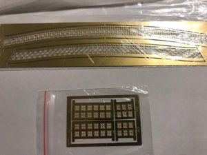

Part Five: Photoetch
This sets the model apart from many kits.There is simply tons of Etch.There are small frets for things like the gunportlid hardware,not just the hinges!Some of the rings are of a size familiar to those who superdetail their 1/350 ships.
Several of the small frets are sorted into boxes,I have only photographed the larger stuff.
Note the Balcony Balustrade,those are things of sheer beauty.
All the stern windows are photoetched but note that the partwork is correct in that it portrays dummy windows for the quarter galleries.These were fake on the real ship.
The silver etched parts are the reinforcement irons for the Tops.
Kind Regards
Nigel

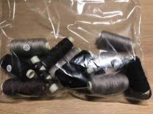

Various spools of rigging thread are included in three colours,these are standard kit fare but not up to the standard of say Amati.
