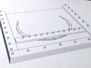

Photo below is the manufactures diagram of how the jig works with holding down the frame when its been glued together.

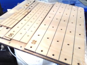

This photo shows how the jig arrived.
Its all laser cut MDF board with plenty of nuts, bolts and washers for assembly.

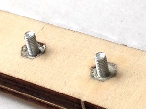

The assembly process called for gluing the nuts into the MDF board with 2 part epoxy.
I coated the threads of the screws with wax so the glue didn't set them rock hard.
After the glue was set, I cleaned off the excess, then cleaned up the threads of the screws.
Its the screws that hold the frame of the ship in place while things are drying. Photo is the underside of the cross brace.

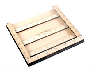

Finally, the assembled framing jig, ready for action.
