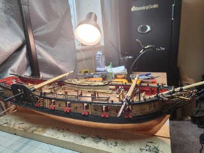

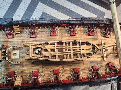

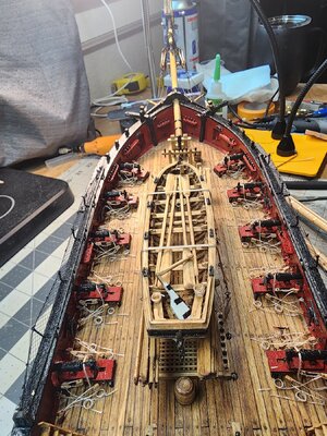

I have been building a Syren model for about 2 years now. I sort of let it go for almost 8 months but am back to working on it steadily. I am also a woodworking hobbyist and love the woodworking detail of the models. Frustrated some times with the scale and my inability to make my fingers do what they need to do, but overall very happy with the results. Although I have some questions regarding things that just seem impossible to make. I am having problems figuring out how to make a rope coil that looks good. The best I've done is wrap a length of thread (.008) around a 1/8" bit and apply a little CA to one side. That shapes it and keeps it together until I can lay it in position. I make several wraps around the shaft and cut off the length I need. What is the process for the hanging coils that would attach to the rigging cleats? I still have that to figure out. Thinking of using some spray starch to hold the shape. Any ideas would be appreciated.
