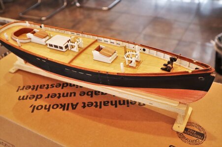

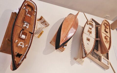

I guess your model will be also somehow based on the group build of the german forum.
For everybody else to understand better here some examples photographed by myself during a forum meeting some years ago
These models are build in scale 1:50, so double the size of your planned project.
Thinking about POF I would check the form of the frames, not specifically the form of the hull, but also take the structure of the frame elements into account.
Such ships were usually not build in double frames, no, it was important to have a light structure. So I guess, they had only floor timber one futtock and one top timber. And also important would be, what the thickness and the width of these frame elements were on the real ship and transfered to 1:100.
Would be elements of rames of only 3 or 4mm thickness possible to handle, to cut, sand etc.
So before decision of POF, you should check how the frames would look like and how big these elements would be in 1:100 ?

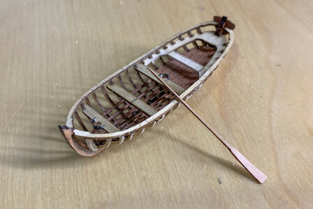

I have built plank on frame ships boats that are only 8cm long so yes plank on frame is completely possible.
Hello,
Thank you, looks great. Will try it also.
VBR Otto
