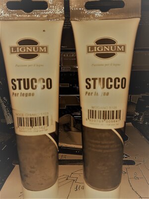

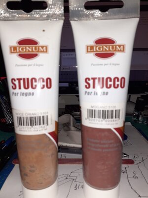

Hello DPT, I would recommend this type of grout, excellent yield and good sanding
I can't find a stockist in the UK. Your photos were blurred so I couldn't read the full details on the tubes. Thanks for the info though. D

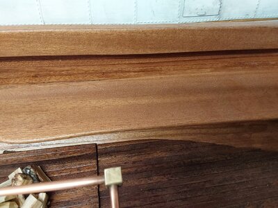

I have mixed mahogany dust with PVA glue and used it with internal planking of my steam pinasse. The stuff is drying very nicely following the colour of planks, and after light sanding you hardly see the filled points. See attached picture. You will find very soon the correct combination of dust/glue when you start mixing them.
