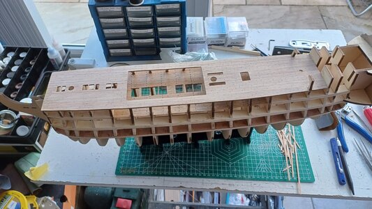

Work is finally underway again. I've just finished planking the middle deck. Next job is to give that deck a coat of varnish. (To protect it from glue spills according to the instructions. 20230815_211141.jpg

Work is finally underway again. I've just finished planking the middle deck. Next job is to give that deck a coat of varnish. (To protect it from glue spills according to the instructions. View attachment 389698
Good morning. Good to see another Mantua Victory. It is a fun ship to build. I don’t know if the 1:98 is a similar build pattern to my 1:72, however I would consider fitting the cannons to the middle deck prior to fitting the top decks. They are a mission to insert with the top decks on especially if you are going to rig the cannons. Have loads of fun it is an impressive ship. Cheers Grant

Step 6 completed with varnishing the middle deck. This is now step 7 and fitting the main deck. I put the masts in just to check alignment all around. Although all 3 are perfectly in line and vertical when viewed from the bow end, side on, the main mast leans slightly to stern, compared to both fore and mizzen which are vertical. Looks like I might have to tweak the holes in lower and middle decks.20230817_170025.jpg

From what I found on the plans and research on the Web, it would appear that the different rake for each mast is correct.

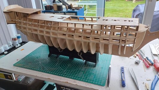

Bowsprit deck, aft cabins and top deck all in place. Decks planked, sanded and varnished. Now the first hull plank is in place on either side. Have just ordered more pins from Amazon, will be here tomorrow, otherwise I'm only going to be able to do one pair of planks per day.
I've used white wood glue so far, but Mantua's instructions say to use aliphatic or vinyl glue for this stage. It definitely needs something faster than white wood glue for hull20230824_151935.jpg planking, or it will take forever.
