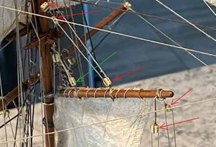

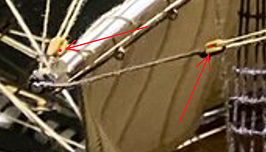

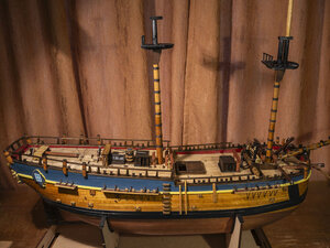

Hallo @Glasetj ,
you wrote in one of your posts "Open to any advise you may have!" , so I would like to show you a small principle error or mistake you did on your two models. Only to mention it, that you will not do the same on the Endeavour. I am looking at this, because I made the same error on my first ship model, and I was so happy, that a friend of mine mentioned this to me once showing him my first model. And you see this error often on models
You installed most of the rigging blocks in the wrong direction. Imagine, that a block has a turning wheel inside and the rope is running over this wheel
I marked shortly the location of the holes in the blocks where they should be - hope it is understandable
The green one is correct - be sure, that this mistake you never will do again
BTW: You are a very good modeler - we really can see, that you have fun and use very good techniques in your models -
I am pretty sure, that step by step you will really build very good models

Hallo @Glasetj ,
View attachment 428241 View attachment 428242
View attachment 428238 View attachment 428239
Here are the building logs of the Endeavours by Occre what we have here in our forum
Thank you much. I thought about it initially and made the wrong decision. Those comments where very helpful. Much appreciated.
I’ve made the same mistake multible times. Some times it’s like “any hole in a storm”. When rigging I try to plan every move in advance. Treading the blocks eventually becomes second nature after awhile.
