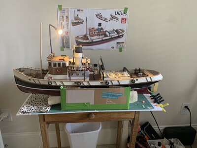

Don. Thank you so much for your response. I’ll visit PETCO. I’m particularly interested in how I can build a good looking cradle for this boat. So that the hull and keel fit neatly and that the boat will sit upright. Best, Richard

LOL. Thank you for your response. I’m particularly interested in how I can build a good looking cradle for this boat. So that the hull and keel fit neatly and that the boat will sit upright. Best, Richard

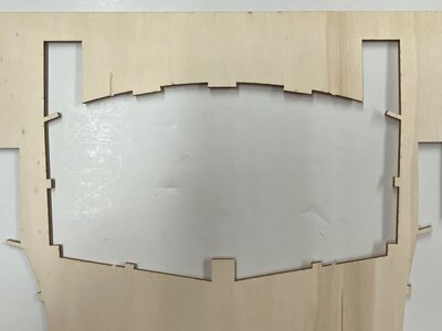

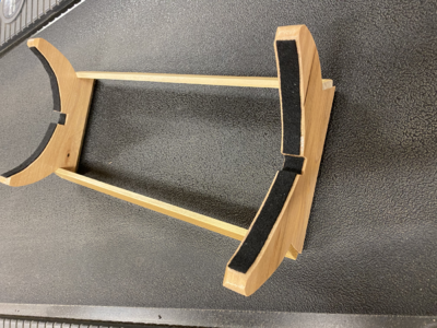

What I do is use the die-cut or laser cutouts for the hull frames (photo), if the hull is planked or sheeted. This is a good way to put some of this "wastage" to good use. You must enlarge this outline a bit to allow for the hull planking and keel, but right there you have the exact hull x-section outline at various points along the hull. After making templates, find a nice hardwood in 1/4 or 2/3 thickness, cut the outline in a jig saw or band saw, and you have the uprights for an attractive cradle (photo).

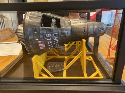

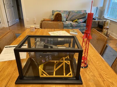

Another suggestion to cover them are sports trophy displays from Michaels or hobby lobby. they often have great coupons for bigger savings here is a trophy case used to hold a football that I put a 1:12 mercury space capsule into. I believe it cost me less then $10. I scratch-built the cradle it is resting on from styrene and foam board.

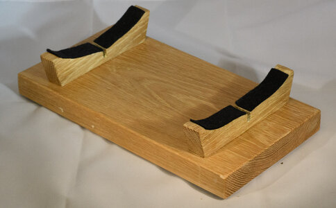

Yep that is exactly what I did. The Occre Endeavour also did not come with a display base and even if it did I suspect it would have been thin and flimsy. I used the cutouts as a pattern and shaped some American Oak to produce a stand which I lined with black felt. The stand was also very useful to hold the model during the construction phase.

Thank you for the tip. Next time I’ll do it instead of tossing the waste.

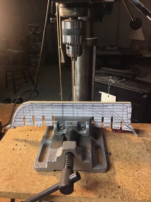

Just to expand a bit on my earlier comment, whether you mount a model to a base with pedestals or in a cradle, it is a good idea to secure the model to the mounting with a pin or screw of some kind inserted into holes drilled into the keel. For plank on bulkhead models the best time to do this is before the bulkheads are glued to the keel piece.
To get the mounting angle right, I clamp the keel piece in a vice at the angle of the waterline and then drill the holes on a drill press as shown in the attached photo. There other ways for doing this, but the important point is not wait until the model is almost done before thinking about how you will mount it.
