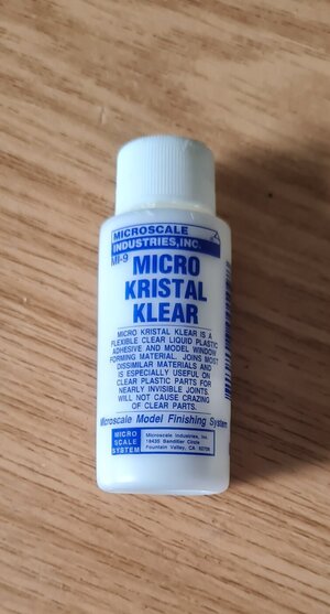

The best products I have found for glueing windows are Formula 560 Canopy Glue from Pacer, and Micro Kristal Klear from Microscale Industries Inc.
Both products start out white but dry clear. The Micro Kristal Klear can also be used to fill in portholes up to 5 mm (1/4 inch) in diameter, and when dry has the appearance of old antique glass.
