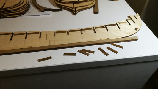

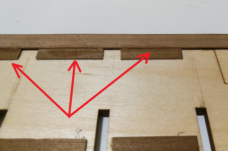

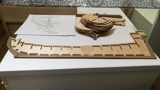

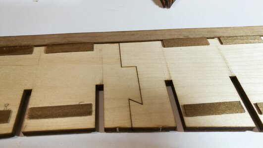

This is a build I am really looking forward to. @Maarten has built an exquisite model of the previous version of this kit, and I was wondering when someone was going to attempt the re-release. I am, however, baffled by function of these strips of wood I have indicated with the red arrows. To me it looks like they fill up the gap between the false keel and actual keel which was intended as the rabbet?

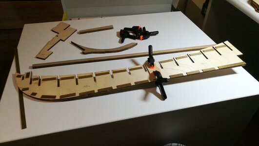

This is a forced procedure (not in accordance with the instructions) because the supplied 2 keel strips after being glued together are 1 mm thicker than the keel plywood. I used these 0.5 mm strips on both sides to align the different dimensions, so that the keel does not twist in the vertical plane.
The keel strips are supposed to be thicker than the plywood keel. This is for your rabbet - the garboard strake will fit into that 0.5mm recess on both sides which equals your 1mm.
In other words, where you placed those wooden strips, is where your garboard strake is supposed to fit in so that it lies flush with the actual keel.
thanks for the warning, but I removed the auxiliary strips after the hernia was completely glued
the instructions included with the kit are complicated and unclear
Good. I normally plank first and only after that has been completed, do I add the actual keel, but that is up to the builder's preference. Is the model single or double planking?
According to the instructions, I should have assembled the keel part in a different way in the first step, which I did not accept due to space and material reasons.
The hull cladding will be made of two layers.
