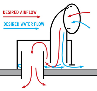

well Stuart.. strictly speaking I think a dorade vent is a specific type of vent; it includes a box that prevents water ingress, while improving airflow.
They where first used on the Olin Stephens designed yacht named Dorade, hence the name;-)

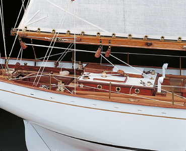

here they are on the Amati model of the Dorade..a beautiful ship for sure..1716730677748.png

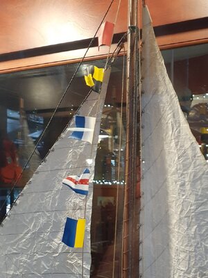

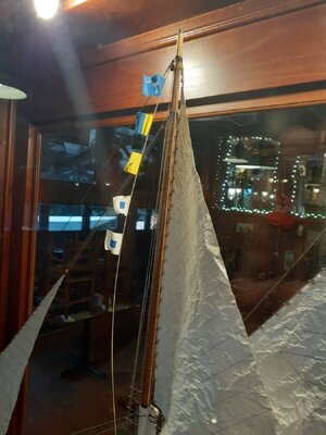

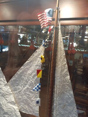

Hoy mates, wonderful conversation. I've been sailing most all my life with two years aboard a 96 foot LOA Top Sail Schooner. I'm 65 and I now crew aboard a 70 foot LOD Sloop. On all of the vessels we would set our available course in accordance with the wind. Using the flags and tell tells we would trim the sails. Guess what? The flags blew in the direction the wind was blowing!!! EVERYTIME!!! On all of my models I set the flags in the direction of the wind.
A wonderful way to simulate the flags and the halyards is to use a electric guitar string. Mount the halyard with some bend, (not too much) and paint it to math the running rigging. Now tie on the flags, use thin sheet of plastic that is painted then warped with a heat gun to simulate a waving flag. I think you can see a good example of the video of me showing the red and white five masted Schooner. The flags are painted plastic tied to a painted guitar string showing more wind with flags and halyard pulling away from the mast. The Schooners sails are set on a starboard tack, shes on a broad reach.
