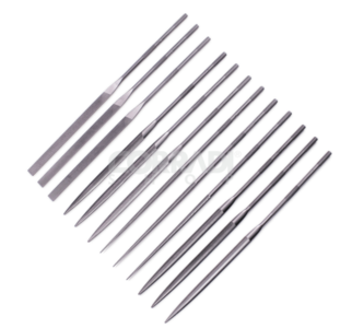

corradi files 12 extra quality 7.i inch lutier set for about 100 dollars cnd would that be a good set to get

You mean this set?

Generally, Corradi is one of the trusted brand names made high-quality files. You have mentioned the Needle Files Extra Quality - 7.1″ - Luthiers' special set of 12
The set contained 12 needle files. They are four shapes: Euqalling, crossing, round, and half-round. Some of them have three different cuts, Cut 0 will be good to do aggressive work and cut #2 for fine\clean work.
  • Needle Files Extra Quality - Equalling - 7.1″ - cut 0
  • Needle Files Extra Quality - Equalling - 7.1″ - cut 1
  • Needle Files Extra Quality - Equalling - 7.1″ - cut 2
  • Needle Files Extra Quality - Crossing - 7.1″ - cut 0
  • Needle Files Extra Quality - Round - 7.1″ - cut 0
  • Needle Files Extra Quality - Round - 7.1″ - cut 1
  • Needle Files Extra Quality - Round - 7.1″ - cut 2
  • Needle Files Extra Quality - Halfround - 7.1″ - cut 0
  • Needle Files Extra Quality - Halfround - 7.1″ - cut 2
However, the set missing 'square' and 'triangle' shapefiles. If the shapes provided in this kit are sufficient for your work, then it will be a good buy! Highly suggested

Yep! That’s the set. That size would be perfect for me as I rarely work in scales smaller than 1:32, or occasionally 1:48.
