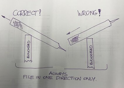

I'm working on my first POB ship model. It is the Lady Nelson from Amati. My plan is to follow the nice, complete, videos on the Amati FB page, done by Modelers' Shipyard. My concern is that the instructor fairs the bulkhead edges, deadwood, stem, etc with a file. (Some recommended a dremel, others warn that they can easily take too much off). I've just tried a bit of fairing, starting with the top of the transom bulkhead and the file delamimated one corner of it very quickly. It also seems to fray the MDF instead of cutting the fibres. What could the problem be? Cheap file? (It is but are pricey ones better?) Should I use sandpaper on a flat block and some on a 1" dowel to simulate the effect of a half round file? If so what grit? Should I use my dremel? I put it aside before I totally mess it up. I thought I would check with you all. I know MDF is widely accepted and shaped, so there must be a better way. The fit of the parts is outstanding in terms of interlocking.

Maybe consolidate the edges of the MDF with a coat of thinned varnish or shellac before trying to sand it.
