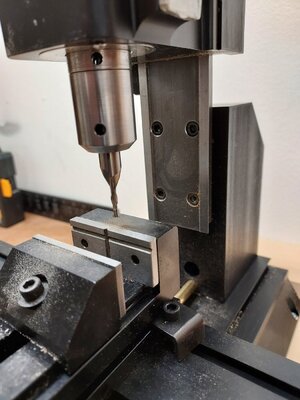

Thank you so much for the information I really appreciate it, I bought the package kit and it came with this end mill holder and 3 collet sizes and some other things, I heard you have some videos on the mill how can I find those I would love to see them , I've used it to make a jig so far and I absolutely love it, thanks again for your time and information..

Just a couple of general points, from my own experience. Typically, the fewer number of flutes the more material can be removed, at the cost of a rougher cut. Conversely, 4 flutes will give you a much smoother surface than 3 flutes, but at a slower feed speed. Also, I do use Sherline's end mill holder, but only with larger diameter mills and typically working with metal or very hard woods. For wood work with small or micro mills I will use a chuck. The resistance forces are not so great. I've never had a mill come loose in the chuck.
It's fun to experiment and be creative flattening the learning curve. You will discover, depending on the tolerances required by the task your performing, it may be more efficient/effective to build a small jig and hand feed rather than set up the vice every time. It just depends on what you're doing.
