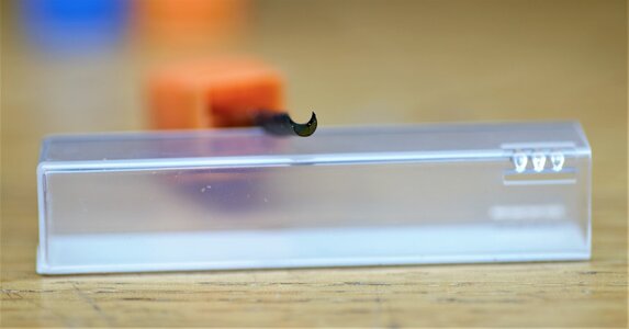

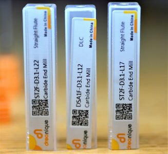

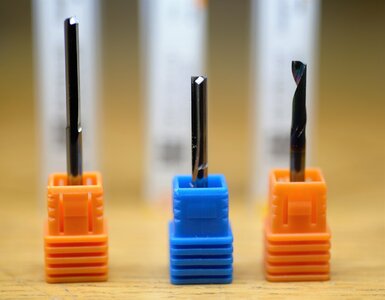

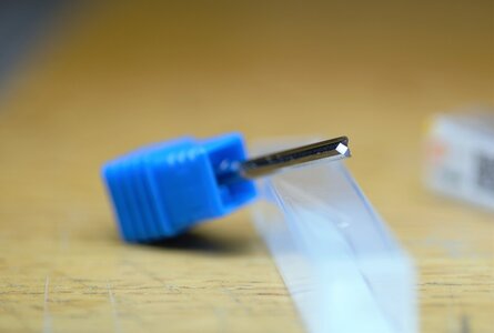

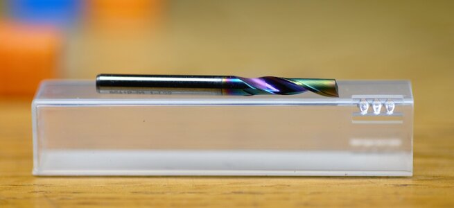

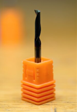

Greeting folks. Today, I received my end mill cutters for my mill, and I'd like to share my joy and happiness. Cutters come in individual plastic containers and have been labeled Dreanique (the brand name). I ordered two types of cutters:

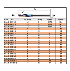

1. Single Flute Solid Tungsten Carbide Alloy End Mill, DLC Coating Milling Cutter for Aluminium
  • Brand Name: DREANIQUE
  • Origin: CN(Origin)
  • Type: End Mill cutter for Aluminium, Tungsten Solid Carbide Alloy, DLC Coating
  • Overall Length:38.1mm, 50mm, 60mm, 75mm, 100mm
  • Model Number: DSA1F End Mill for Aluminium
  • Diameter:1mm to 10mm
  • Flute Number: 1 Flute, Straight Flute
  • Coating: DLC
  • Material: Tungsten Cobalt Alloy
  • Degree: R0.1
Here are the charts of available cutters

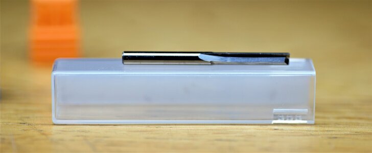

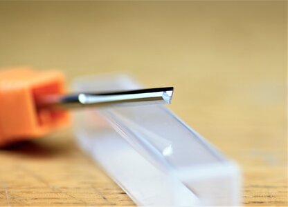

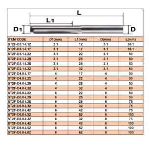

2. 2 Flute Straight End Mill Carbide Straight Slot Milling Cutter
  • Type: End Mill cutters, Carbide Milling Cutter, CNC Router Bits
  • Overall Length: 38.1mm, 50mm, 60mm, 75mm, 100mm
  • Model Number: ST2F, D3.175 D4.0 D6.0 D8.0
  • Diameter: 3.175mm 4mm 6mm 8mm
  • Coating: NONE
  • Degree: R0.1
  • Flute Number: 2 Flutes, Straight Flute
  • Made of: Tungsten Carbide Alloy
  • Applicable Machining: Slot Milling, Parting, Grooving
  • Applicable Material: Solid Wood, MDF, Acrylic, Aluminium, Copper, PVC
  • Coating: No Coating
  • CNC or not: CNC
  • Customized or not: Customized
Here is the chart for available sizes.
The first impression - professionally made, very sharp, and handsome :) I tested both types of cutters on my Proxxon mil using the Boxwood and Pear, and the results are above expectations. Clean and smooth cut. Cutters bought on Aliexpress with free shipping. If you buy by a pack of 10, you will save some $$
