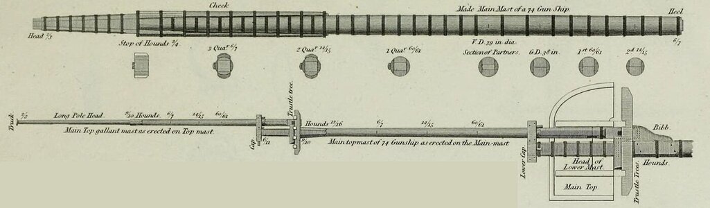

As I know, the doubling (length between the cap and the hounds is often also called "top" or "head", and it is the difference of hounded length of the mast and measured length of the mast counted from the mast foot - so there are some difinitions and rules (I think)
Maybe this contemporary book can also help (it is from 1843)
